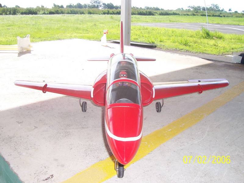

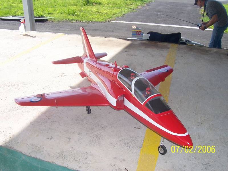

Did my maiden today. Takeoff was marginal, but gained speed shortly after. Nice smoke trail. Blew out the engine hatch, but it landed closely. Did not affected the trim. One retract did not came out, but landed it slow enough that there were no issues.
Used about 15% flaps on takeoff, but rather than help, seemed to add too much drag. 15% nitro sport fuel with 1 oz turbine oil per gallon.
No flutter (5945 in the elevator). Bough the kit from JHH when it came out. Glad I finally decided to finish and maiden it.
Will like to coax out more power from the .46VX. Not sure I lean it just right for takeoff. Don't own a tachometer anymore...

Edgar---you don't need a tach---Use the pinch method--Pinch the fuel line and close the needle until the pinched line won't allow the engine to lean anymore then back it off a click or two--Use a mixture control to adjust from there. The pinch method takes some practice to get perfected---If you hold the pinch too long you will lean out the engine and not get a good needle setting...A quick pinch it what it takes---BV tought me this almost 20 years ago!!!

Kevin,
Thanks. Will do the pinch method..
Mike,
I did my best to make sure those setscrews in the elevator yoke were tight and loctited. I'm not sure I will be willing to put a turbine in it. I do have an Artes Bee in the shelf. I beleive the Wren guys are/were flying one with a the 8 pound version.
Anyway it's good to do something different once in a while (my 1st DF).
