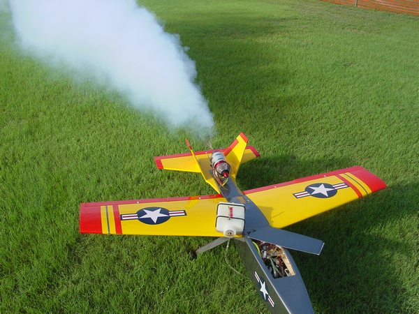

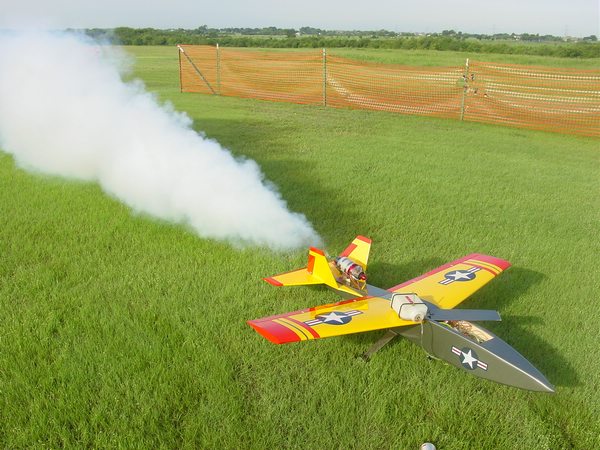

Your right about the smoke. I put my Tamjets system in and sure makes for some added fun. I used two leftover Aermacchi 15 oz. saddle tanks I had. They fit perfectly on the sides of the main tanks.
Only problem is transportation....this thing is BIG. One piece 7 foot wing. Shopping for a trailer to make it a little easier. If you have a Suburban or Excursion you are all set. Expedition may do also but I haven't tried it. Fuse is 86 inches and wing is 84. Most vehicles like a Trail Blazer size would be a tight fit. Problem is the Fuse has to go inbetween the front seats because of the length but then the wing needs to also share the same length so you would need a high rack like a closet bar near the cieling. I manage it in my Mercury Villager van by sliding the wing under the rear bench seat and the seat folds over like a table that the fuse sits on and the tail sits on a removable shelf that comes with the Villager.
It took three days to figure that out and be able to leave the back seat it. But its a tight fit and I have been shopping. Just keep it in mind. This is a BIG bird!
