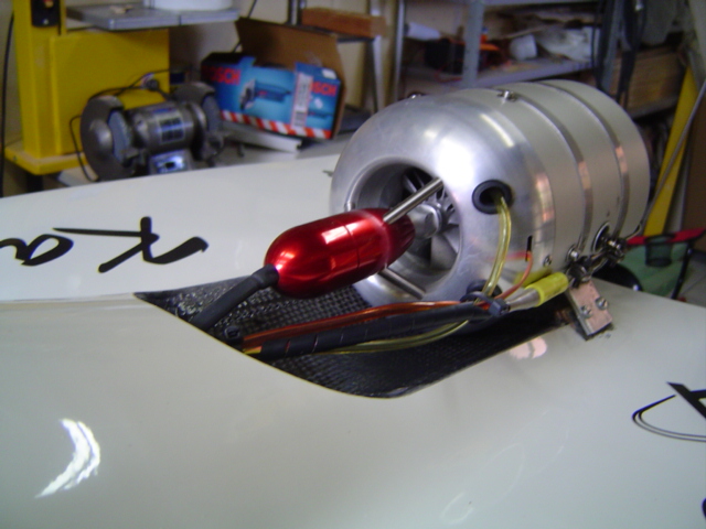

[img][/img]
My new Kangaroo[img][/img]

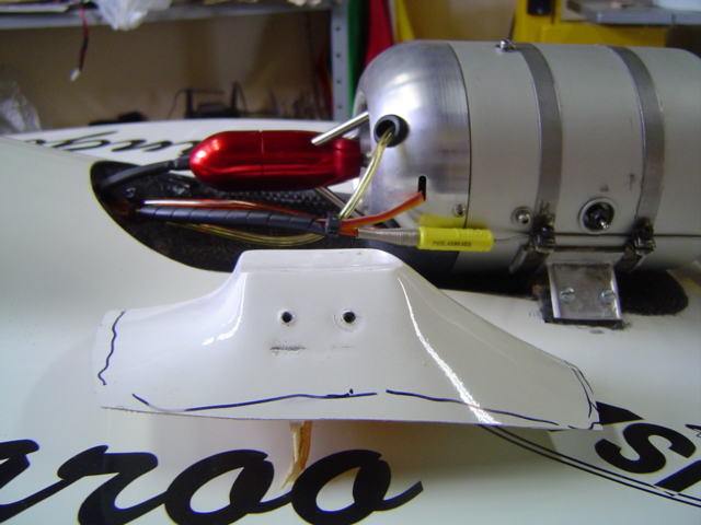

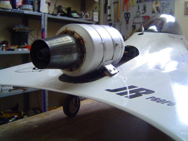

more pictures[img][/img]

Thats a T750 right? you like it?

Legal Hiran, voce voou ele sempre com a turbina mais baixa do que a original, ou vc ja voou ele com a posicao original ?

In was going to ask Hiran if the lowered thrust line made a difference to the way the 'roo flies.
Did you just do that?
John
Old 04-26-2005 | 10:27 AM
erbroens's Avatar
Joined: Nov 2003
Posts: 4,292
Received 16 Likes on 13 Posts
From: Curitiba, Parana, BRAZIL
Default RE: kangaroo
Yes, it makes a brutal difference. It flies pretty much like the hotspot wich has no discernible pitch
trim change at different throttle levels. But, there is a loss. you cant make the famous kangaroo
flop... and thats why I am rebuilding my roo!

yes, the turbine is FTE 750 and is very good. I have two fte-750, one kankaroo and other in hot spot.

John, just recieved a PM from Hiran and he asked to me to tell in my slightly better (?) english
that he flew the first flights with the roo with the original mounting and he hated how the plane
pitched down at low speed at 100% power. So he lowered the thrust line and improved it very much.but it still needs some engine angle to make it perfect.

[img][/img]
My old kangaroo

Hi. Nice engine mount revision. Well done, good thinking. Paul.

attractive this modification!!! This is for getting more speeds?
Hiran, mas com certeza realçou pra melhor a aparência do Roo!! Parabéns!

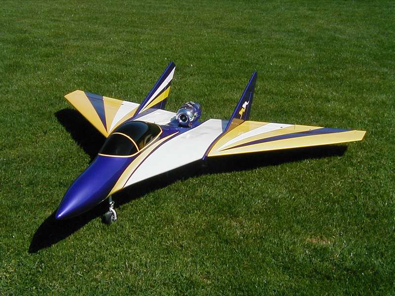

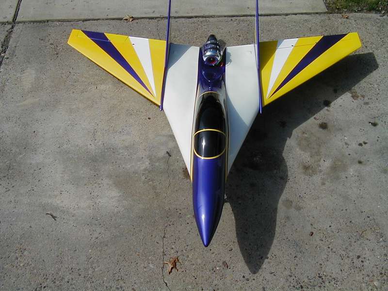

Here is my Modified Roo. Flies Great and now CG is no Problem
Ron

Help - I have a Fiberclassics Composite Roo that I bought 2 years ago at the Superman Jet Rally. I put a Jetcat P80 in it and it is almost ready to fly. I have taxiied it about, but I need to balance it. The original instructions call for the CG to be located 95-100mm forward of the wing tube. This places the CG 4" forward of the wing tube or close to the main retract struts. Is this the correct CG position?
The P80 is mounted on the pod with 3 washers under the rear of the P80. Is this correct?

1) Yes, this is the right c.g. position
2) Yes, this washers help to reduce the pitch down tendency at full power in lower speeds.
