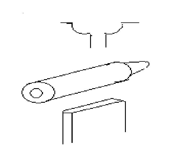

Anyone seen a pylon type mount for a turbine, I have a PST600 that I am looking at mounting on a pylon? I have done a quick sketch to illustrate, OK very rough but it IS early.
Any ideas?
Bart

Bart, not a lot to work with there, but you might try an upside down "roo" installation. Do a search for mouting turbines to a Kangaroo. You will find a post by auther "seanreit" related to laminating 6 pieces of 1/64 ply and aeropoxing the home made cradle to the Roo fuse. The only difference would be orientation and I would add some screws through the mount into your what you are hangining off of. If you decide this route, I highly recommend making the center section of your misile there out of hardwood etc. Hope you get my point.
Sean

you need one of these things from PCM models
Whatcha planning? I was thinking the yellow thing, but you already got the Ram on it......

... Are you looking at something like the mount on the AV8R....from PCM..?

Hard to see on the PCM website about the AV8R but I am looking at having the vertical wooden plywood beam and then mount the turbine on the top, that is what I was trying to get across in the drawing, not well obviously. Nony I would like to centre the turbine on the beam therefor your piece wouldn't work unless I used 2.
The mount would then consist of 2 pieces on the bottom to make the bottom half that would bolt through 1-1/4 mount, 2-beam, 3-1/4 mount, and then use the normal 1/2 round pieces on the top. I am planning on mounting a fibreglass 'structure' over the engine also, which would be a cowling type of structure.
A bit hard to say, I can see it clearly. I might have to make up a prototype or just find some metal of the correct type and bend my own.
