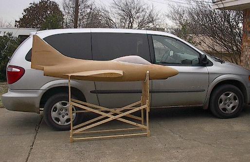

RE: your 110% Ziroli Panther...I have almost finished the plug for my 127% Ziroli Panther. 1/5th scale: 91.2" wingspan. I'm afraid it will require a JetCat P160, at least
Johnny
Johnny
Johnny

Ozcan asked:
"Johnny- how is the big kitty coming along?? "
Marty,
I'm still about where I was when we corresponded earlier. My mold maker has been too busy with money making work.
Hopefully, I will get the mold made and a fuselage pulled before winter sets in. Til then, here's a photo of the plug next to my "aircraft carrier"
Johnny
