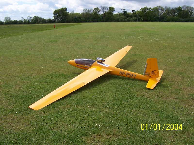

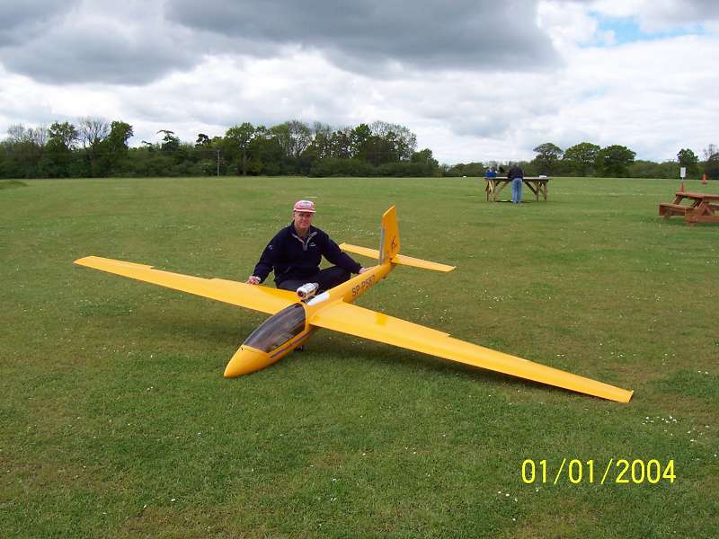

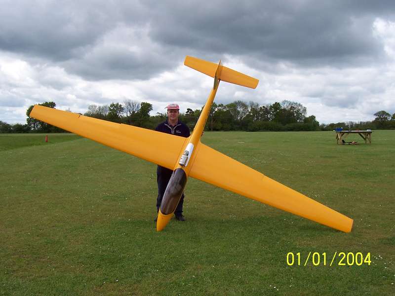

Just had to share with you all this creation. we had an Airworld swift aerobatic glider but no tug to aerotow it. We then had the idea of mounting a turbine on the top and make it self launching. The turbine is an AMT Mercury (not an HP) but it has adequate power to launch the glder from grass. Now we can take off and fly aerobatics on the way up !!!
Next thing its to try aerotowing a power model behind the glider ??!

Swift on its own weight 35lbs and with the turbine installation it now comes out at 41lbs. The turbine provides very little drag and the glide performance seems unaffected. The glider aerobats even better now due to the additional weight providing more energy.

Does the vertical stabilizer deform by the exaust heat?
I'wd like to know the thrust line with respect to the wing cord.

No problem with heat distortion. I started off with a heatsheild on the front of the fin but took it off as it was not needed. you can put your hand on the front of the fin with the turbine at full power, its warm but nothing to worry about. The thrust line is set at 0 degrees relative to the root wing incidence and this seems about right. just a very slight climb at full power but this is probably more to do with the increased airspeed.

If the model has a wheel then take off should not be a problem. You will need someone to hold the wingtip off the ground at the start of the take off run...just like the full size...but as soon as the model is moving control is easy. The take off run with my model which weighs 41lbs and has a 8.5 kg thrust motor is about 30 to 40 yards in light wind conditions but I can haul it off much earlier if I need to.
The cross sectional area of the turbine is very small and I can detect very little difference during the glide. The additional weight of the installation has actually made the areobatic performance better as the model has more momentum.

At that weight and size a 54 size turbine will provied more than enough power. you may even be able to de-rate it a bit and save on fuel consumption....or climb very fast.
If you are worried about heat on the fin make up a simple heat shield. This can be done from lithoplate folded around the front of the fin. set it forward of the fin by 15 to 20mm and attach it to the sides on the fin with 3mm spacers to allow an air gap. I was concerned that fitting such a sheild would have an adverse affect on handling but it made no difference. You can see the heat shield in the posted pictures.
