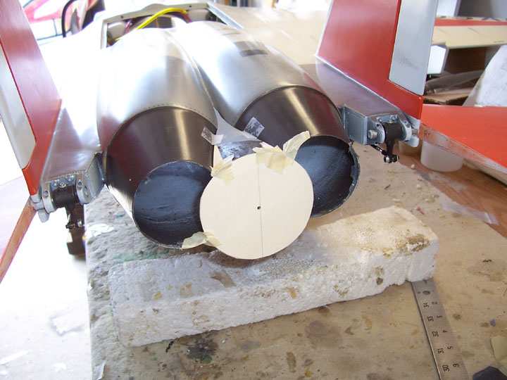

Ronnie,
Single wall bifurcated pipe
Length.... 18"
Inlet Dia. 2.5"
Outlet Dia. 1"x 2
On center... 6.25"
Pipe was for JPX setup in Avonds F-15..... you think this might work for you ?

the outlet pipes would be centered at 4.5"
The overall pipe length is 19"

Thanks Countryboy.
I think we have the solution to run with now though.
Lowering the engine and pipe makes things on top look much better.

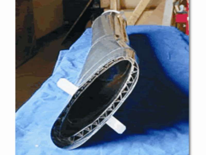

Why not a round to oval pipe transition? ... I think that it could work as long you pay attention to the cross section areas . you will not have any thrust angle issues with this one.
btw, found this pipe made by Tam too.
BR, Enrique
