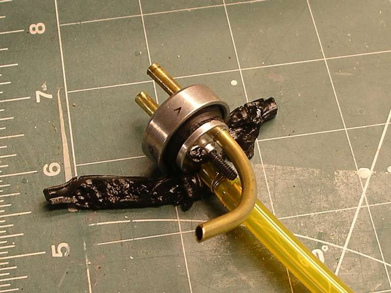

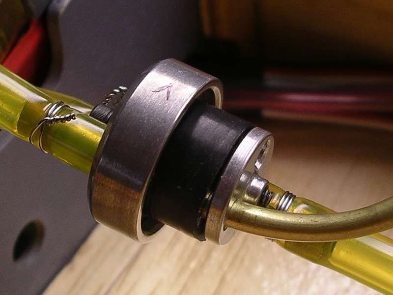

The following photos show two BVM fuel stoppers from tank kit #T619. I bought two kits. One I used on my 32 oz main tank, and one I used on the 24 oz collector tank.
I've only run 2.5 gallons thru this new jet.

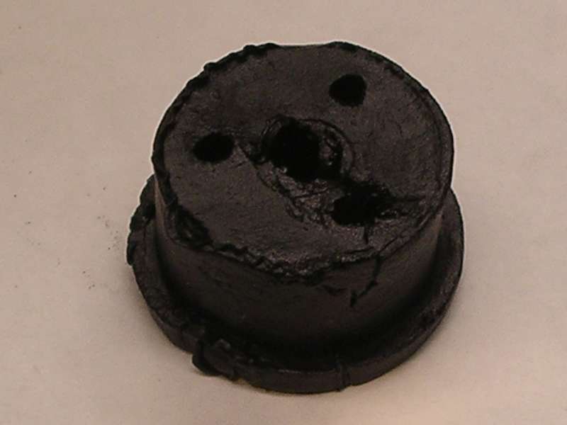

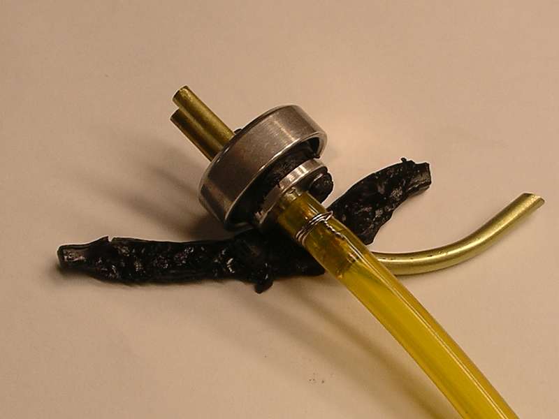

While removing my engine from the jet today, the stopper on the 32 oz seems fine, but the 24 oz tank stopper came apart in my hand. I'm using clear K-1 and 2380 synthetic.
The only thing I can figure is the smaller 24 oz tank with the bad stopper is not always emptied during a typical flight, or engine run. The UAT is the next tank in line from it. Maybe that stopper soaks in fuel more. But should it have disintegrated? The UAT and in-line filter is clean , but there were large and small pieces of the stopper in the tank floating around. These stoppers have only been in use for three weeks. How often should I replace them? I'm wondering if my other jet buddies should do an inspection on their jets.

Looking at the bad stopper closer, it appears to have compressed more with the set screw. Maybe that cracked the stopper and allowed fuel to soak in. I don't know. If this is the case, I would think Kevlar tanks could cut into a stopper even more if there are rough edges at the opening. My Dubro tanks seem to have smooth openings.
I decided to do some testing for myself. I took a new DuBro black gas stopper fresh from the package, and soaked it in my K-1/2380 mixture from my fuel can. After 3 hours it looks like that in the photo. Unfortunatly, within the first 30 mins of soaking it was already deforming. I need to go to the Hobby shop and buy the brown stoppers, and others intended for gas, diesel, and Kero for soak testing. I'll post my findings. I've done a search on RCU regarding this subject with little results.
I'm not sure what brand to use in my jet now. Am I doing something wrong here?

Sullivan makes stoppers BLACK for gas, white for glow and Dubro is black for glow and BROWN for gas.
So not all black stoppers are ok for gas/kero.
Is it possible that the black (gas) stoppers got mixed up with black (glow) stoppers?
