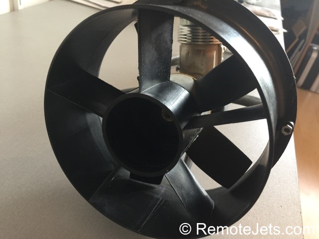

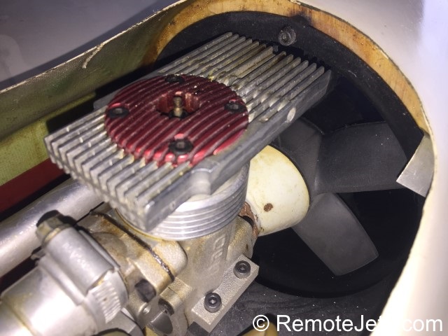

I am doing the same but with ducted fan power Dynamax and O.S. 91. I got the main engine and exhaust duct from Yellow Aircraft. I am going to modify just about the whole kit. I trashed all of the hardware that came with it.

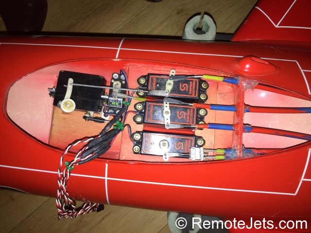

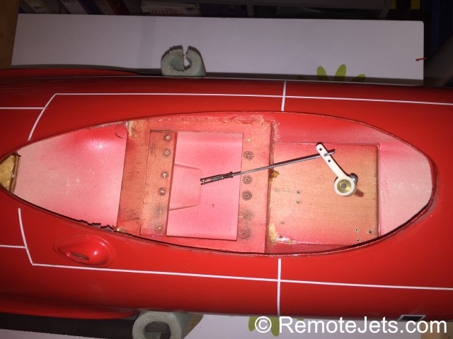

Well, I just wanted to post some info about my progress with the Mig.
In this picture you can see the elevator servo mounted partially up into the fin. It's mounted to two formers that I made. Two 4-40 rods are connected and will be soldered to a third which attaches to the control arm with a heavy duty ball link. The servo is a 645 MG and I think it should provide sufficient torque for the elevators.
The foam fin former is in there just to test the rod movement, I am going to add a wood plate to the aft portion of it.
For the rudder, I am going to use a pull-pull system as suggested earlier in this post. It should work well.

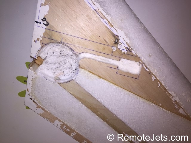

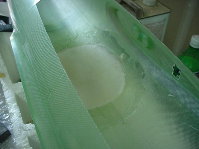

Here you can see that the hole in the bottom of the fuse has been closed up. I used mylar taped around the fuse with wax paper between the mylar and fuse and fiberglassed. It worked very well and I am happy with the results, the outside of the fuse has perfect shape.
I cut the top hatch first in order to make closing the hole easier. I have also made new 1/4 inch ply formers for the wings and engine to mount to.
I am going to lay in CF tape around the fuse at the main former to add some strength and rigidity to the fuse. The formers that have been added to the rear for the elevator servo have stiffened the rear of the fuse quite nicely.

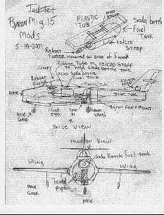

Originally posted by dhoke
I'm trying to rebuild a MIG, and have no original kit plans. Would you be able to tell me how to hook up the fuel valve/lines? I don't think they used pressure.
Dick Hoke, [email protected]
Dick,
just use a 32oz soda bottle 2 line feed / pressure system - works great - simple - no leaks and no lean runs.
I do not know how to make the drawing larger when you click on it - maybe some one can tell me how to do it.
Jackjet

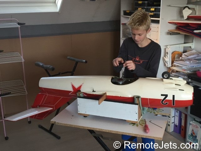

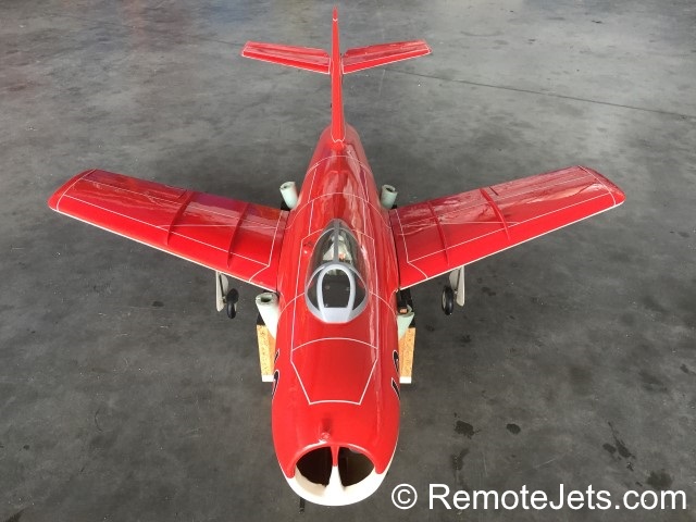

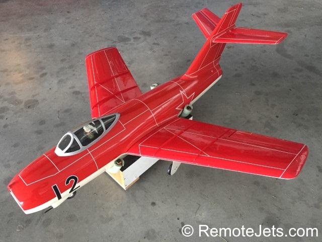

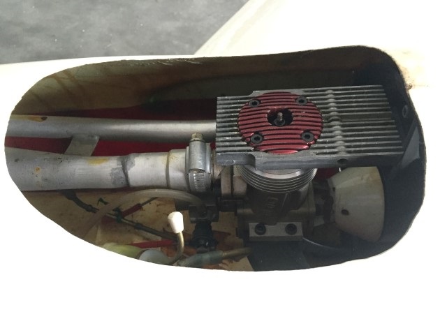

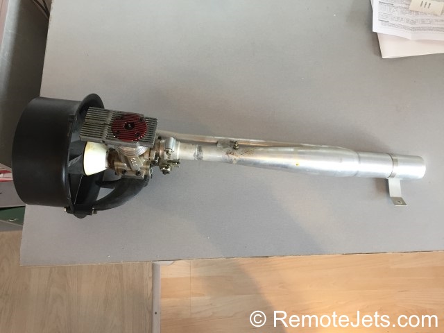

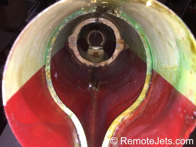

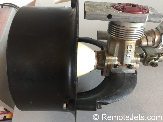

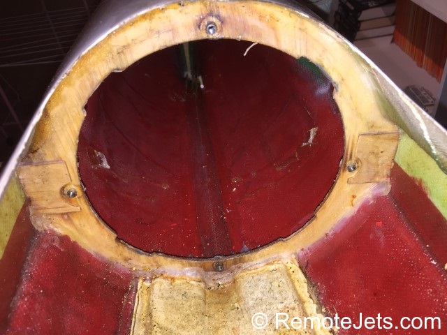

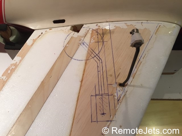

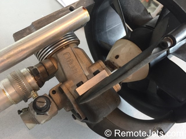

I recently got a Byron MiG 15 pushed in my hands with the message, 'it would be nice to see it fly again, see what you can do with it'.
So I started with a conversion for turbine
Model will not be a scale model but a nice sport jet scale.
