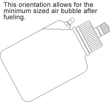

Hi Guys,
Yesterday I made my 7th flight on my Eurosport, I´m using a rinho and I live at 8000 ft. I made an emergency landing and it seems that the turbine took some air, giving me a scary flame out. [X(] This is not the first time that I land like this, but today we know that it was air. So my question is for help about how to make a perfect purge of UAT . Can someone help ?

Reading from other posts and from The JPO site at this link: http://www.jetpilots.org/PDF%20files...M_500_Tips.pdf
You need to disconnect the line that coming from the UAT prior to it going to your fuel pump and pump it back-wards through your system. I followed this procedure and after 40 flights have yet to experience a flame out. Other more experienced than I might have some better suggestions. But for me it has worked perfectly. Other info:
http://www.bvmjets.com/tips/uat.jpg
It is important that the U.A.T. (Ultimate Air Trap) BVM #6044 is mounted in the model such that it is visible during the engine start and runup. Position the U.A.T. as per sketch if possible. It can face forward in the model or aft with good results.
After startup, run the engine at full power for about 15-20 seconds and observe that the fuel level in the U.A.T. does not decrease.
If it does decrease, their is a minute air leak in the fittings (tubing) from the tank that is feeding the U.A.T. This minute leak may not be obvious at less than full power demands on the system.
HOT REFUELING
If you choose to hot refuel, the time interval between disconnecting the fueling line from the U.A.T. and replacing the line plug is critical. The fuel level in the U.A.T. will decrease, therefore it is best to pinch the line from the U.A.T. with forceps during this disconnect period of time.
Multiple Tanks - check for even fuel consumption
During the initial engine and fuel system check of a new installation, observe that the tanks that are plumbed in parallel burn off equally. If they don't, there is restriction in the slower tank's plumbing or an air leak in the connections to it.

Thank you very much, I think I had an air leak because the uat drop its level a lot and the thanks were half full. I´ll check all of this again.
Thank you.
