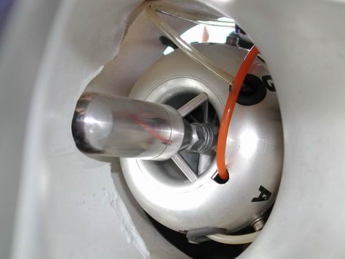

We installed PST J600 starter to AMT Mercury for semi-auto start. Works nicely thus replacing the need for scuba tank or compressed air. Utilize external 6-cell nicad. We can option to change to full auto start ecu but the current system works nicely with minimal modification. Picture coming.

picture.

Very nice picture. The picture was shot from Panther, wasn't it?

It is your Panther, Mr. Jeww!! and your AMT engine as well.
Thank you for your thrust and support. Many inquiries onto this modification already.
