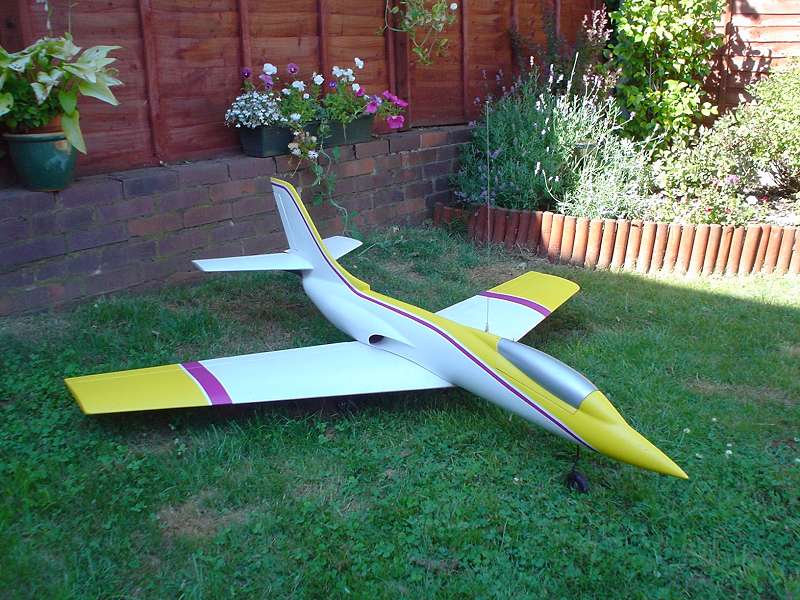

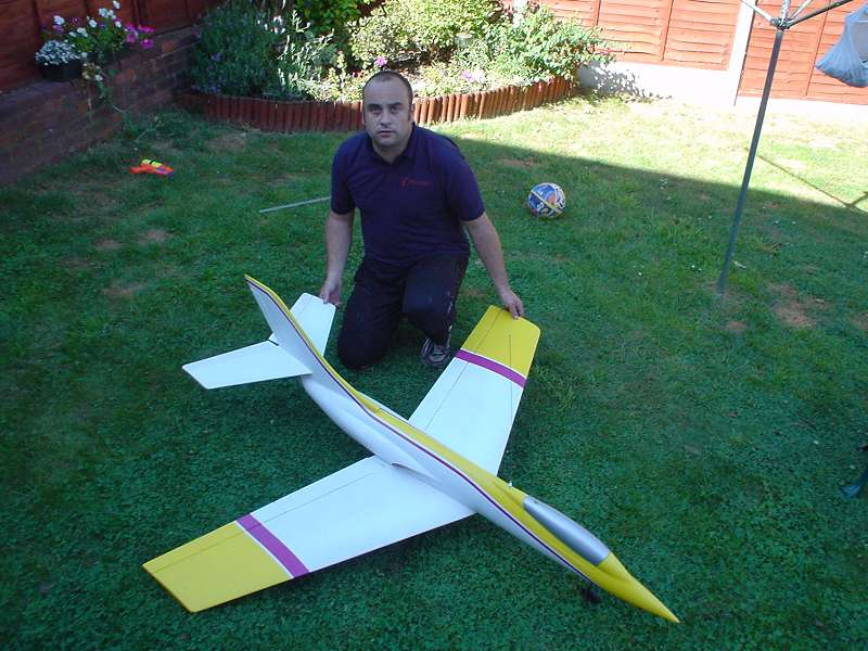

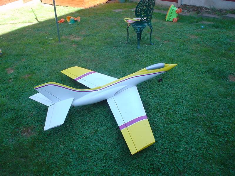

Hi everyone,
I've been building this model on and off (mostly off) for 2 years but here it is ready to fly hopefully monday. Just something I wanted to share.
Digi servos
simjet 3000 (derated to p80 ish power)
15.5lb with full UAT and some fuel in the main tank.
Not wishing to go down the is it strong enough for that power - 3/8 carbon / ply laminated spars through the length of the wing and tail + loads in the fuss. She will be mostly off the power anyway.
All the best and wish me luck ay
Ant

Ant,
How much lead up the nose??????????????
Laura

Default RE: Dear World - Its Ready to Fly
Laura,
Not as much as what everyone was saying I'd have to (a few ounces) but I do run a backer on all my jets so there are 3 bat packs as far up the nose as poss.(2 reciever and 1 ecu)
I surpose I will have to get cracking with my bobcat now - just hope that doesn't take me as long as the starjet did.
ant

Looks great ! I need to get working on mine again. Should be more than enough power ! What elevator servos did you use and are they stab or fuselage mounted ?
Good luck on the test flight !
Marc

Mark,
used jr mini digi's 5+kg metal geared etc one on each in the stab.
ant
