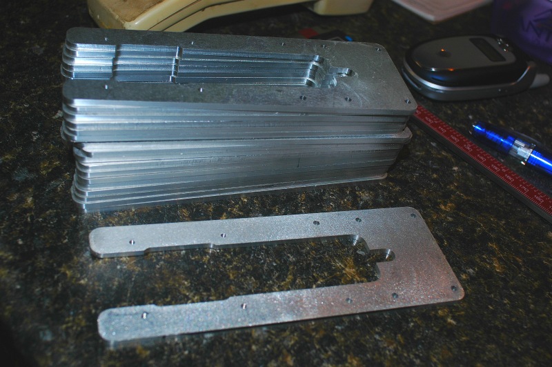

I have a few Aluminum KC plates (4-6) I made on my CNC mill..
They are $25 each... $50 per plane.. mains only...
I can run another batch if I run out..
Eddie Weeks
[email protected]

Eddie, can you post a picture of the kingcat set? Are they already tapped?
Old 08-05-2005 | 10:53 AM
Posts: 1,146
From: Baton Rouge, LA
Default RE: KINGCAT FLEX plate ?????
When I get home I will post some pics.. Yes they are tapped...
I know these plates fit... But I don't know how much stronger they are...
I am sure they are tougher against impacts, but they still may bend some..
They are not near as strong as the Titanium one I made a for the SB.
Eddie Weeks

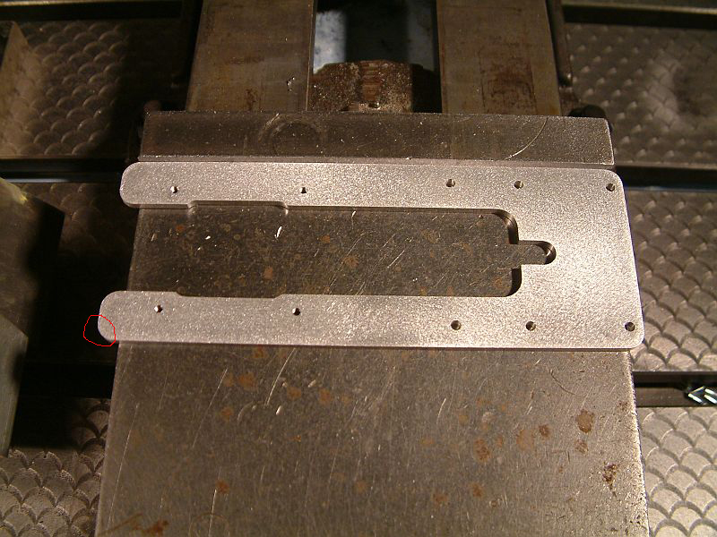

No worries, the only reason I want a picture is on the stock plates, I have to grind a corner of the plate to allow my retract line to get between the wall of a former and the plate. I don't know how much work that would be to put that notch in on a titanium plate. And I don't know if everyone else out there is running their retract line in this configuration.
There is allready a 1/2" notch for the airlines.. This is not in the orginal plates..

I think we are talking about a different notch...
Either way its easy to notch these plates.
My stock plates required a notch as indicated.

I tried a new method of holding down Aluminum in the Mill..
I just glued some 1/8" plate to a 1" plate.. Cut it... drilled it.. and tapped it... no problem..
Anyway I ran a new batch of KC flex plates... If you want I can cut the notch but you will
have to tell me how many air lines you want to pass through there..
$30 for two..
Eddie Weeks
