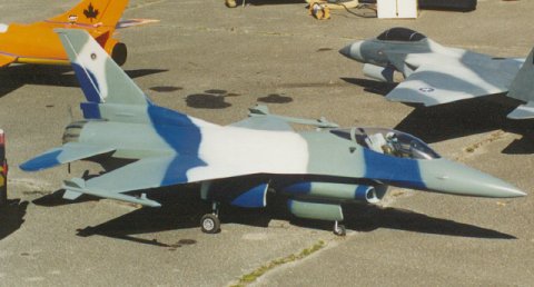

Old 10-23-2002 | 12:28 PM
lov2flyrc's Avatar
My Feedback: (24)
Posts: 6,102
From: Daytona Beach
Default Engine mount combat models f16n
Originally posted by YellowAircraft
Todd,
You had the CBM F-16? Was it stock?
Hey Shaun,
Yes, my CM F16 was stock. YS45 RE with mac pipe and header. Flew great!! I had well over 125 flights on it when I gave it to Jaye to prep him for his yellow f16. Amazing how much power they have on a .45 engine! I miss it .
Badchev, dont suggest using .60 engine, the YS 45 on a tuned pipe has as much power as a basic .60, plus you need the pump of the YS to get the fuel to the engine. Seen two on .60's that flew like crap compared to mine on the .45.
Todd
