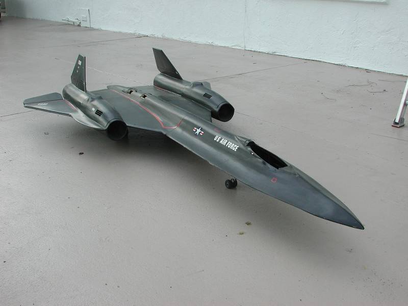

Hi Guys
I have a friend who's uncle was in the Hobby about 10 years ago. Recently he passed away and left his Estate to my buddy. Upon helping him sort out many items in his basement I discovered a SR71A.
As luck would have it the plans were there as well as the Drog Chute. There were what looks like Ram Tec 5 inch Fans minus motors. The landing Gear is Mechanical and seem to work while the Servos are shot.
My friend gave me the SR71A since he knows I'm an RC Junkie and if anyone can fix it I will find a way.
I made a Phone call to Charlie Lines up in NY he used to be a very Familiar with the Yellow Kit as Lance Campbell is. This Model Measures 105 inches long and 57 inches wide. Empty weight Minus Motors is 20Lbs. It's all wood and glass many wood formers. This is not the Yellow Kit.
Enclosing some Photos my question is it worth making her ready for flight?
I would need 2 DF motors, 10 servos and misc hardware.
Let me know what you think.
The Hatches were removed so I could see whats inside them but there all intact.

I think the SR71 flies fine, many have been flown in various sizes, most recently, a giant one in Germany, all balsa like this one, flew like a charm.
As far as collector value goes...this has NONE. Built up models, unless they are museum quality(this one looks nice, but FAR from museum quality) have very little value. THe best hope is that some resturaunt will want to hang it from the ceiling.

The fuel tanks, though, should be removed and replumbed. Not a big deal.
You need two OS 91 df engines...and two pipes. Don't forget the pipes. So it IS somethign of an investment needed, money wise. Twin turbines? That's a whole nother ball of wax.
You should fly the thing! All you need to do is keep both engines running, and all should be cool!
Don't beleive all the "it won't fly" jive about the SR71, there is nothign wrong with the configuration, some crashed, sure, but it's not unflyable. They said the same thing about the 117, yet it flies fine, in spite of the experts loudly proclaiming it would not.

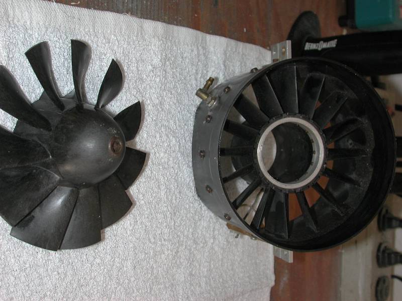

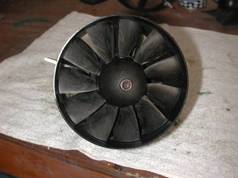

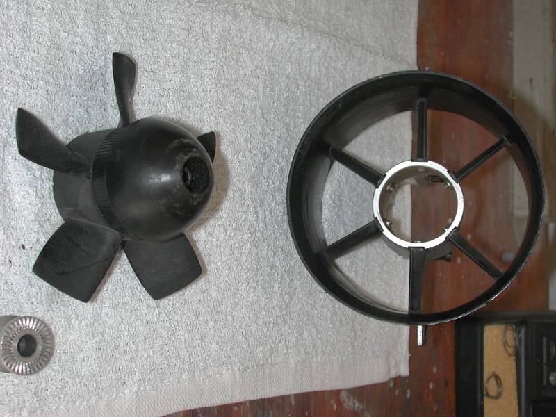

Alright
The Project that wasn't suppose to progress appears to be moving forward.
I need everyones help again I'm enclosing a series of Photos showing the original Fans.
Some research leads me to think they are called Turbax III Fan Unit am I right.
As luck once again has it a friend that runs a LHS has this other Fan and a in need of repair OS91 DF
Looking at this fan I think it's a Ram Tec is this correct?
Now several questions The Ram Tec has many more Compressor Blades. This indicates it's more efficient at lower RPM guessing in the 20K range.
The Turbax fan looks similar to some WeMoTec Mini Fan indicating high RPM would be best say 40K but I doubt a gas engine can turn those RPMs it's probably just an old design.
The OS91 needs a new Barrel and new Gaskets all around. It looks like a older engine.
Any incite you guys have I am all ears as I am not a Glow Ducted fan expert.
Ian

You can use the Ramtech fan, no problem, but stay away from the blown engine. A new piston and cylinder is $180. A new engine is $300 or so.
There are many bargains to be had on new or slightly used Ramtech or Dynamax OS91 setups, they are always trading hands here and on ebay and such. I would hold out for $400 for each setup, with the pipe, for new or near new. I would NOT want to be mussing with a rebuilt engine of unknown origin on a twin with the engines way far apart like that, just to save a little bit of money. If a piston and cylinder was only $50, you might be saving a lot, but they aren't!

I noticed the RamTec has a pressure fitting behind the compressor to pressurize the fuel Tank. Is the BVM stuff much superior to this?

The pitot fitting for the Ramtech is not ramtech specific, any of the fans can use either pitot or pipe pressure, and it's one of those "two schools of thought" things, I always used pipe pressure, but I'm beginnign to think pitot pressure is better because if the pipe comes out, you engine will still run. Just saw a freind do that the other day with a JHH hawk...something came off the airplane, I did not realize it was the entire pipe!

The fan with the 11 blade rotor is a Dynamax by Tom Cook at JMP. The pitot pressure works very well to pressurize the fuel system. Looks like you have JMP System II tuned pipes also. You can't do any better than what you have unless you go turbine. IMHO you won't pick up any performance by going BVM unless maybe you go with his latest fans and BVM .96s and if you're going to spend that much money, you might as well turbinize her. Dynamax fans have been flown in larger and heavier airframes than anything BVM powered.
