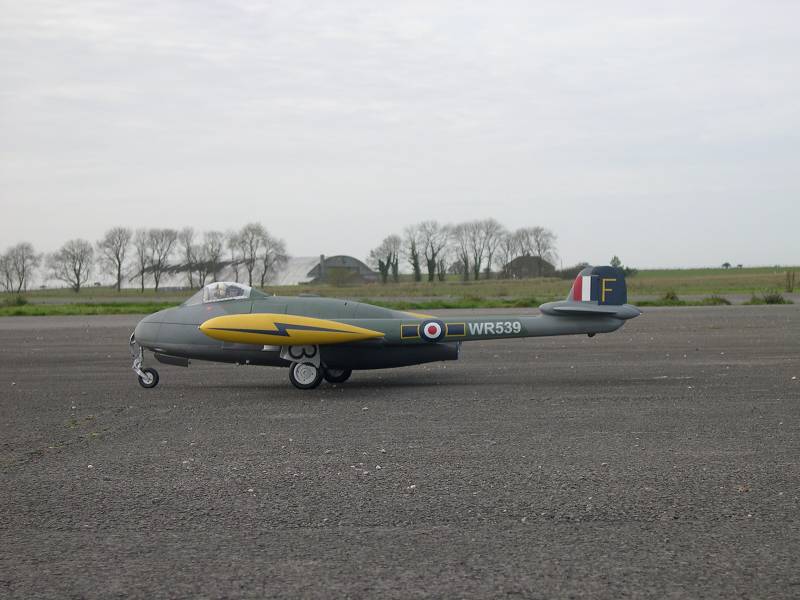

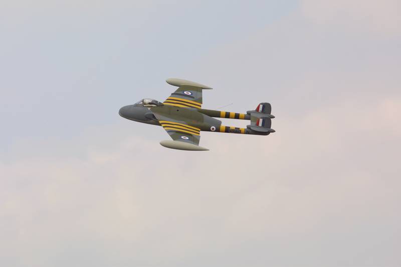

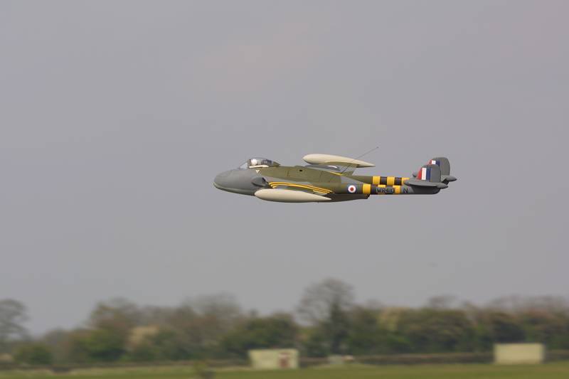

Mick Reeves' jets are generally very accurate in scale outline...his Venom is a smallish model, flies very well and, above all, is a classic British design! Ian Bailey did a build thread on RCU a while back - search for that for detailed info on the model and mods Ian made to improve it.
