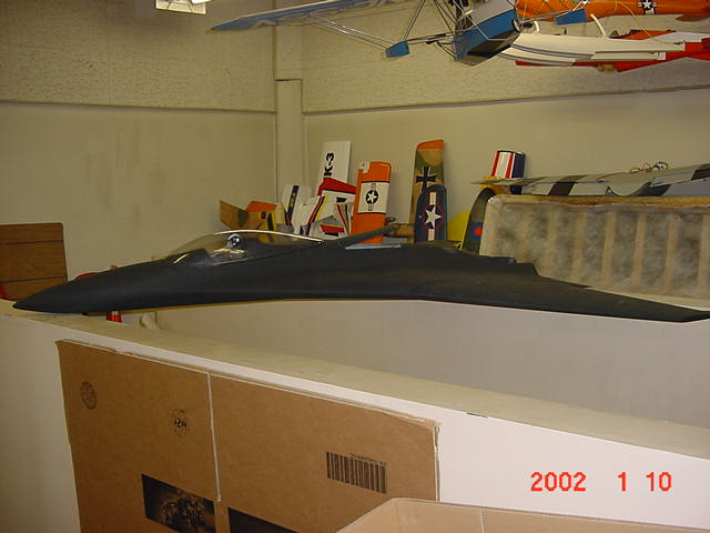

Default speaking of Spots Hot!
Hmmmmmm I wonder!
Old 01-11-2002 | 06:03 AM
  #31
JohnVH's Avatar
My Feedback: (38)
Posts: 16,179
Received 10 Likes on 8 Posts
From: Ferndale, WA
Default Re: speaking of Spots Hot!
Originally posted by AirRayInc.Com
Hmmmmmm I wonder!
I wonder where your rudders are!

Default Correctamundo!
And you are right Steve, who needs em. I have a very high performance slope glider that is a full flying wing also.
But this one is not mine, if it were...... this, along with a few other minor laterial stability additions would be the finished product. Yeah Black too.

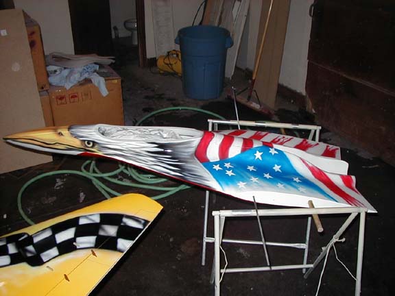

Default Hotspot
Here is my customer hotspot.
http://tamjets.com
