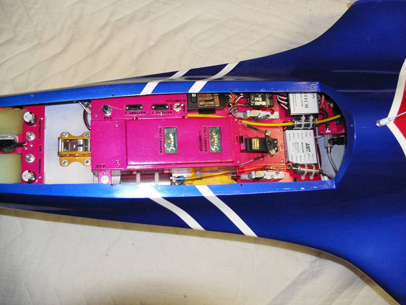

Few images of our Euro Firebird

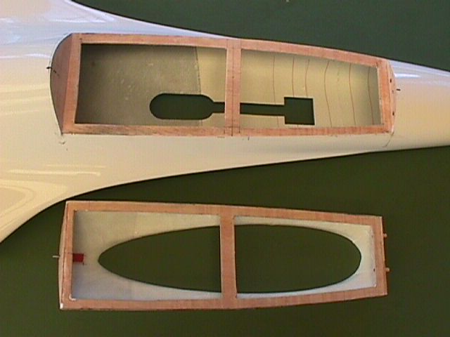

image of canopy/hatch enlarged ....NOT SO SQUEEZEY
ID:	331484   Click image for larger version
