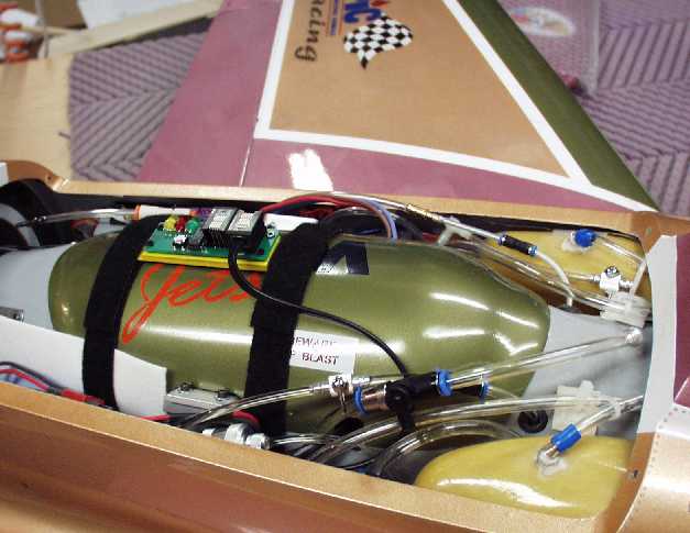

Can you use a velcro strip wrapped around the whole assembly ?

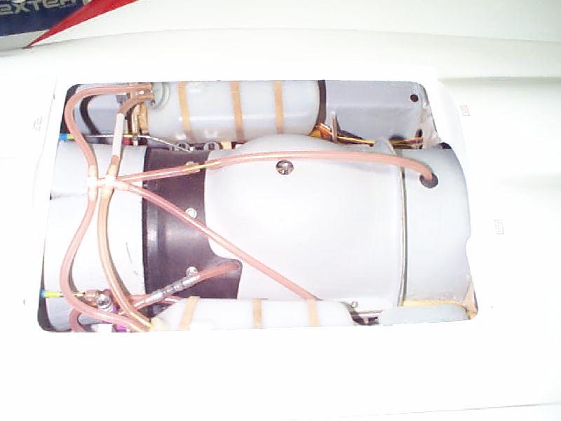

Yes I have been thinking of the velcro option, it seems neater and faster/easier to use. the only thing is the thrust tube is not as rigid as the turbine bypass tubes. I dont know if i will be able to make the velcro tight enough. i guess I will have to try it first.[img][/img]

ORIGINAL: clr2cont
Hey! I recognize the model in the first pic. That's a Spirit Jets/MDM Sweet-16, which is a sport-scale model of the F-16.
Yes, the velcro option works fine in DF. Rigidity in the tailpipe isn't critical as it'll be under positive pressure when running. Even if it's a little flexible when the engine isn't running, it'll become tight when under pressure. So, all you want the velcro to do is keep the tailpipe hatch from lifting.

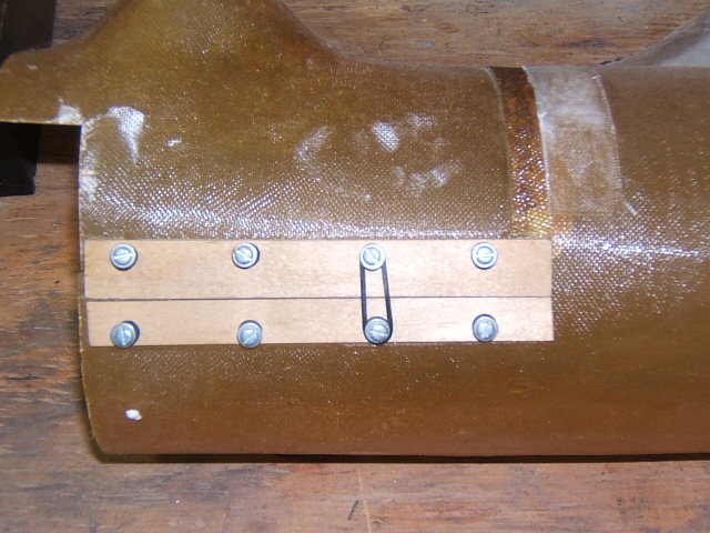

On several DF kits I've had the fiberglass engine cover had flanges on them. You epoxy pieces of thin plywood to the flanges and secure with blind nuts and allen screws. I would usually glue thin strips of foam rubber to the mating surfaces to act as a gasket. If you look carefully at this picture you'll get the idea.
Joe
