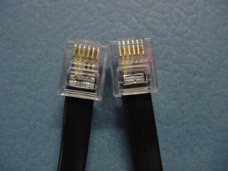

Is the data cable on the JetCat a standard phone cable? I'd like to make custom lengths to keep things neat. Anyone know a source?

Call JetCat USA. They will make a cable for you at any length you desire. I suppose you can make your own, and I have had a connector fall off one from JetCat, so their's are not infallable, but for me, that's the easiest way to get a custom length one...

The JetCat cable is NOT a standard phone cable. A phone cable will damage your ECU.
You can buy the cable ends and the crimper to shorten them yourself, but you have to get the correct connectors. I was using the wrong connectors and had some trouble until I got the right ones. The connectors must be for multi-strand wire. The normal phone line connectors are for solid wire.
Make sure you look at a JetCat cable to get the orientation of the connector correct. The connectors on both ends will be crimped on the wire, exactly the same. Notice the color coding on the wire is the same on both ends of the cable.

Digi-key. IDC modular cables REVERSED. look at there online cat. can get in 7,14, or 25 feet. in straight or coiled lines. make sure you get the 6 position 6 contact one( i thnink it was 6, count your cable). i ordered one from them a while back. works like a champ.

no !! it is not a standard cat 5 ethernet cable !!! check the pin outs before making your own !! and yes they can be made using cat 5 cable but you have to crimp on your own connectors with the propper pin-outs ... a cable made with the wrong pinouts will blow out your ECU !!!

The connector in question is an RJ-11. They can be purchased from Radio Shack or any other reputable electronic supply. I spent about $35.00 for the crimper. The connectors were out of stock, so I bought a package of them and 50 feet of cable from Home Depot.
Just be sure of the orientation of the plug. One side of the flat cable has a raised orientation rib running lengthwise.
