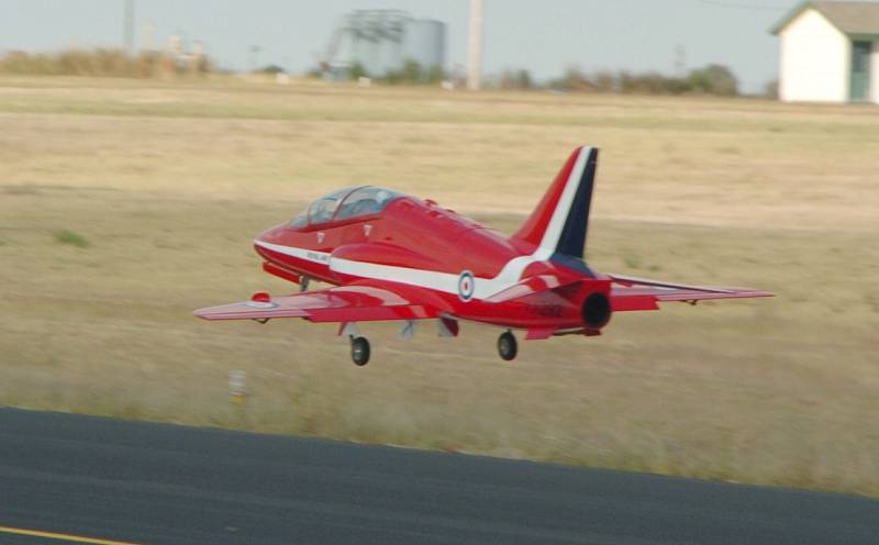

I have had no problems with the flaps on my hawk.
But, I need to point out that that as a full scale pilot, the real planes have very explicit gear and flap speeds. The toys are no different than the real ones it is just harder to judge air speed on the toys! Exceeding these speeds causes bad things to happen and is not the aircrafts fault.
I have done several practice go a rounds and a few for real also, with no problem. I always take a notch of flaps out on climb out as the gear is coming up them remove the approach/takeoff flap setting on cross wind turn out, or about 1/3 of the way on a vertical climb-out that is where the P-120 is a lot of fun!
I would go up high and fist stall your plane to see what it does then circle back around and extend the gear then some flaps fly one circuit then extend full flaps to get a feel for the plane. If it is rolling your flaps may not be coming down equally, better to find this out at altitude then in the pattern.
Stick with it until you get your plane set right and don't be afraid to use the flaps.
You can see where they are set in the pic below on a go a-round.

May I suggest you gentlemen take a look at my review article on the SM Hawk in RCJI . I made some suggestions, and flight tested them and my Hawk is totally docile., throughout the flight envelope. My suggestions were based on fullsize practice and the experience of Duncan Simpson during early flight test of the real Hawk, when control was temporarily lost during stalling trials with flaps extended.
In short, :
Use two powerful servos on the stab.
Mass balnce the stab.
Limit flap angle to no more than 1 inch of depresssion at full flap, half that for take off and approach.
Set the stab. trim slightly up about 1/8th inch for take off/ approach flap , about 3/16th inch with landing flap.
Set up like this the model is a delight to fly.
The results of early problems with the Hawk can be seen by the deletion of about two feet of the outboard section of the secondary flap.
The problem was the strong downwash created by the flaps on the tailplane. In addition flap extension caused a nose down pitch, (probably due to C of P shift) which required uptrim on the stab. the result being a stalled satb.
The model seems to replicate this extremely well !

My Hawk is powered by a Jetcat 160 derated to 120 standards so the idle thrust is unchanged. There is no problem with excess thrust at idle on approach, in fact, power is required.
The Hawk flaps are small but effective, but do produce strong downwash on the stab. and it is possible to stall the stab. If this happens and the machine pitches down I guarantee the pilot will KEEP the stick back until impact so the stab is never unstalled. Include the mods. and settings I quoted and I doubt you will have a problem, they have been flight tested. Although they are small the flaps DO make a worthwhile contribution to lift and drag and it should not be forgotten that they also "wash out" the wing, making flight at low speeds safer. If you want more drag just use aileron upset as Ali suggests (crow), that also adds to safe flight at higher angles of attack at low speed.
I use flight modes and the flap system on the 10X. This allows the flap angle and stab angle to be set to maintain trim. This trim can be fine adjusted in flight using the normal trim switch and the flight mode system will memorise them, makes life very easy.
Two more points:
Limit max stab. travel to 15 degrees to protect agianst stab. stall. (I will measure mine when I get my transmitters back from calibration)
Set the Tx so that flap movement is slowed, giving you more time to correct if things go wrong. If an uncontrollable pitch down ocurrs retract the flaps immediately.
