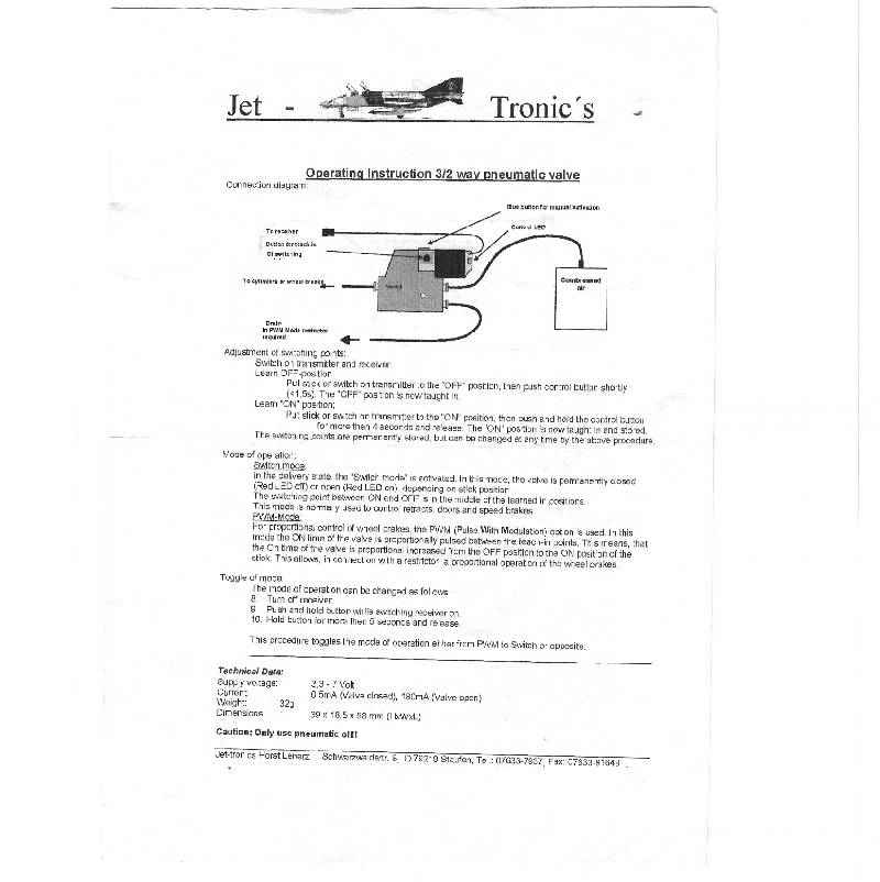

I have jet tronics value (Black) Need the set up procedure......

Joe,
Not sure which one you have, break or retract but this should help?

Duh...if I had read...you did say Brake valve....so...

Thanks for the diagrams Todd. We discovered Uncle Joe had the lines hooked up backwards grrrrr. All is well now.
