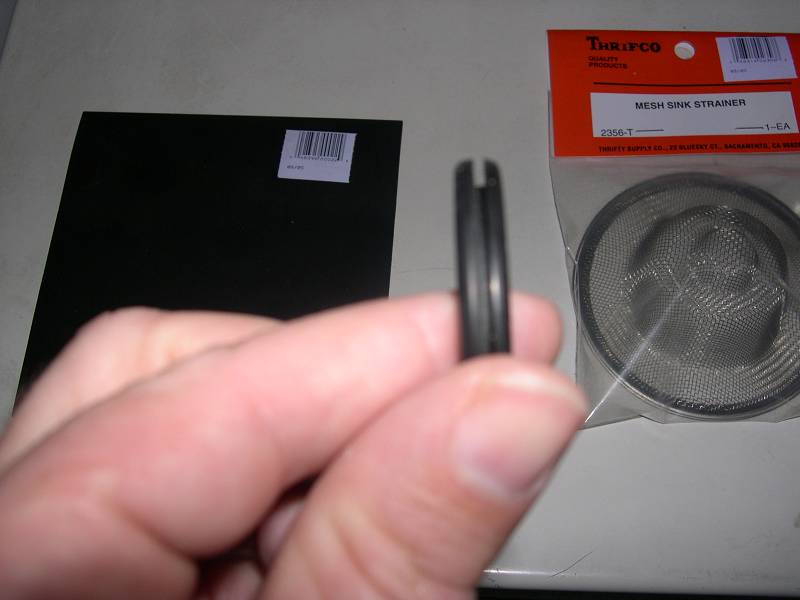

Since the statrer motor on my BMT 120 is inside a polished aluminium case, I didn't really want to get it all scratched up by using the same kind of FOD screen as I have on myu Jetcats (where the black plastic starter case won't show minor scratches from the ends of any cut-off wire, I decided to come up with a slight variation on the usual theme. In case it's of any interest to anyone, I'll post some pics here.
A trip to my local Ace Hardware store yielded all the necessary components - a sink strainer of the appropriate diameter, a sheet of rubber for me to make a rear-gasket with (for between the FOD screen and the cowl), and a nice big grommet whose inside diameter exactly matches the diameter of the starter case. As you can see, the grommet has a nice deep channel in it where the cut ends of the strainer will go. (I lost several f the pics I took, so hopefully descriptions of some steps are enough.

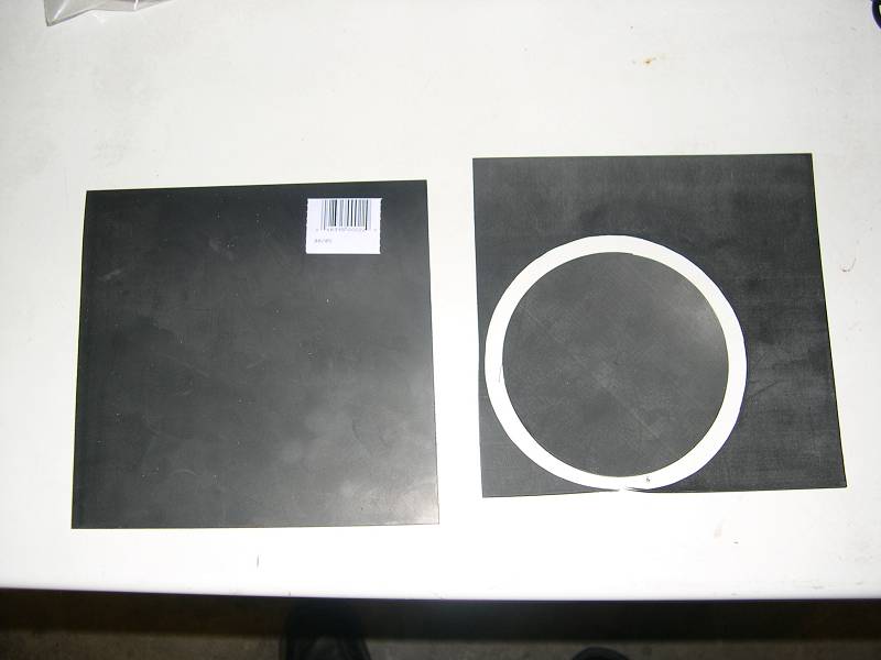

A circle cutting tool was used to cut a suitably sized ring out of the rubber sheet, to act as the gasket between the FOD screen and the cowl.

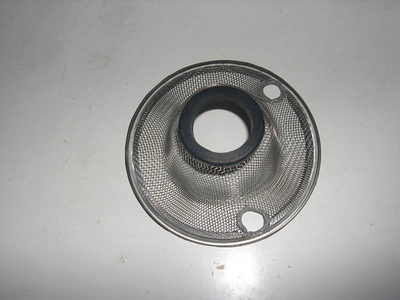

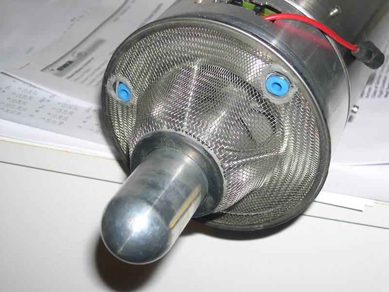

I measured the outer diameter of the grommet, subtracted twice the depth of the groove, and cut the appropriate size of circle out of the strainer center ; the grommet was then fed into the hole, and a small bead of glue used to help secure the wires in place inside the groove. The smaller holes for access to the Festos were also made. at this time. Then I glued the rubber gasket to the rear face of the strainer & let everything set.

The finished item in place. Now all I need is a working engine so that I can test whether the FOD screen does what it is supposed to...

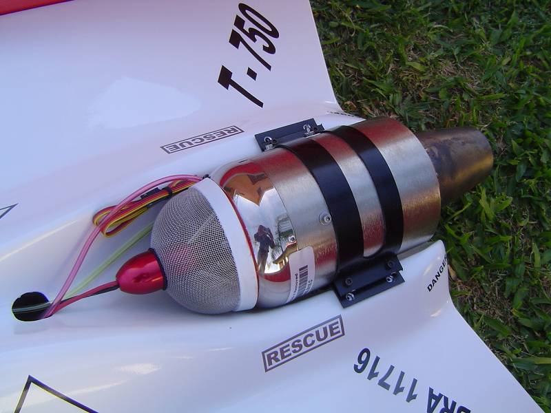

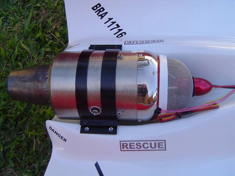

This is my made home in Brazil.
Hiran
