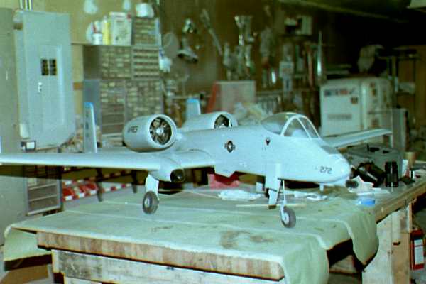

Default Would an A-10 be a nice Beginner?
The Sunset Models and George Miller A-10 Wart hogs ARE Not the same.
I have had both.
The Miller is Very scale and quite a bit larger than the Sunset version. Sunsets was "Stand way back and squint scale" Atleast the one I had was!
AND the Sunset one had a goofy airfoil that was nowhere near the "Scale undercambered airfoil that the Miller kit has.
Here is a pic of the Miller F-glass fuse version I built for a client.
Old 11-08-2002 | 12:38 AM
Posts: 154
From: CA
You are correct that Miller's and Sunset's are not the same. I stated that incorrectly. At one time, Miller and Buz Evans of Sunset were business partners and the A-10 was a joint project for a period of time, I believe. However, when they split, they each did their own version. Miller's were off the Beaulieu drawings--which are quite accurate.
Does anyone know what happened to Miller's A-10 molds? Haven't seen nor heard of George Miller in about 10 years--about the time he was getting out of the hobby and the business.
Larry
