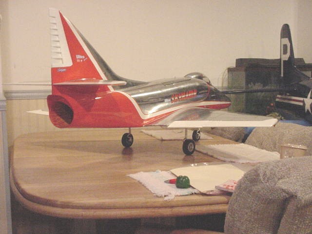

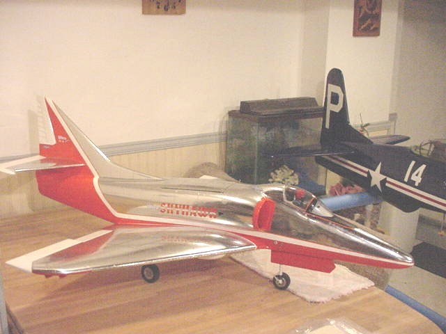

I am hoping to sell an old YA A4 DF that's been in mothballs since '93.
It's never flown off grass, but I need to set it up to be able to fly off a small grass field for the buyer.
The A4 has the sport wing, OS91/Dynamax w/Performance Specialty AAC liner/piston, Boca ceramic bearings,
weight=14lbs wet. The power and rpms are there, just doesn't seem to have the thrust for grass.

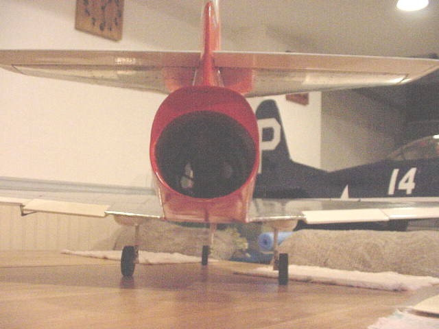

Currently the thrust tube exit diameter is 4 inches. I would like to change it to 3.5 or 3" to increase the static thrust. Has one done this? What is the optimal diameter for the thrust tube outlet?

At 14lbs thats gonna be tough, its hard enough for a 14lb byron jet to get off of grass. And how short of a field are we talking? Bigger wheels may help a little, and the only other thing I can suggest is moving the CG back a little or maybe moving the rear wheels forward a little so that the plane can rotate easier, but if it does rotate be careful it will be flying slow and easy to stall, if it does get off you will need a clear and flat area ahead of you, keep it low and level until you pick up speed, if there are any obsticals at the end of the runway don't even try it. 14lbs on a Dynamax fan from grass will be very tough.

I have changed to larger wheels. I'll try and move the mains forward, but it will not be by much.
The fields is surrounded by trees and bush, so if its not up and climbing in 300 ft there may be trouble.
Shifting the CG is going to be tough due to the placement of the fuel tank and the limited space in the engine/fan compartment.
Any thoughts on increasing the static thrust by reducing the outlet diameter?

As far as decreasing the outlet diameter to increase static thrust I'm not sure. I know there is a sweet spot in thrust tube designs, too big and you loose efficiency or too small and you loose efficiency. I don't know any of the equations to justify these statements and not sure how much +and - you can do to increase thrust. But I would think that maybe making the tube a little "larger" may help increase static thrust and I may be totally off, but I know that the larger diameter byron fan units created more thrust than the dynamax, and the dynamax had more top end speed, but I know the actual design of the fan has a lot to do with it too... So I'm really not sure on that part

I don't think that'll work either. I've been testing a BVM Viper with an electric system in it. Witht he stock ducting and 3.4 inch exit nozzle and a 5 inch fan I was only getting 5.5 pounds of thrust. I whacked the nozzle off and opened it up to 4" and the thrust went up to 8 pounds +, power input went up too as the fan was partially stalled with the choked down exit...

Just another thought, make sure the front strut has a positive angle of attack while sitting on the ground. Normally, this plane will take off fine if all things are set properly. I have owned one of these, but it did not weigh 14 lbs.

The light bulb went off in my head to try decreasing the exit diameter by creating an adjustable temporary adaptor to
reduce the diameter at various interval and measure the thrust levels. We'll see!
