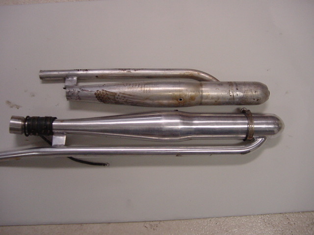

#40
Hi Gary,
Well i have Byron pusher set up on my jet, this pipe starts as regular pipe, half way down starts to flair to 1.5" diameter and ends 3" after that, then just before end there is exhaust pipe extention that is smaller diameter that comes out from side, bends towards engine and ends just before fan unit itself!...so what you think what pipe do i have?, i still have todrill and put back pressure nipple on it.
Sammy
Sammy

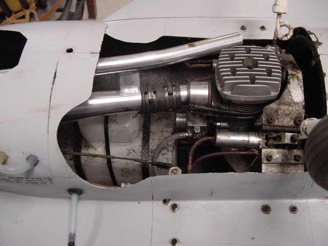

#42
Its almost like the one in bottom of pic on left, but its squaired off instead of capsule end. So i guess its not OS pipe but its byron.
Another question for you, whole floor inside of my RE is glassed except for area right after the air intakes!, its about 3-4 " width and across from one side wall to another, just wondering if i should glass it or leave it!, i am concerned if i ever had fuel leak inside of the fuselage and floor getting soaked...
Sammy
Sammy
#44
Posts: 3,759
From: Fort Wayne, IN
ORIGINAL: joeflyer
Sammy,
Sounds like you might have the TGA High Volume Pipe. If you post a picture I could tell you for sure.
Joe
Sammy,
Joe
#45
My Feedback: (18)
Silly question:
I am thinking about adding a short piece of tubing to the end of a similar pipe to get the exhaust out of my fuse. I don't want goo building up inside the fuse once fuel goes throught the Byron fan. Is this feasable? Would the extra tubing cause the engine to experience excessive heat? would it rob me of performance? Is there any good reason not to do it?
Anthony
Anthony
#46
Posts: 3,759
It will work. All the Goo gets on the outside of the plane instead of inside the thrust tube. I did it on one Byron F-16 I had. but went back to adding a short silicon tube so it dumped just in front of the fan. I took the thrust tube out every few weeks or so and washed it then put it back. Easy to do with the lexan/mylar tubes.
#49
