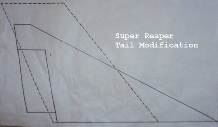

As far as the fins go, let's just say that the British either hit it (Spitfrire) or they don't (Fairey Swordfish). I redesigned the fins to make them more palatable IMHO. They seem to be stronger as well (see below).

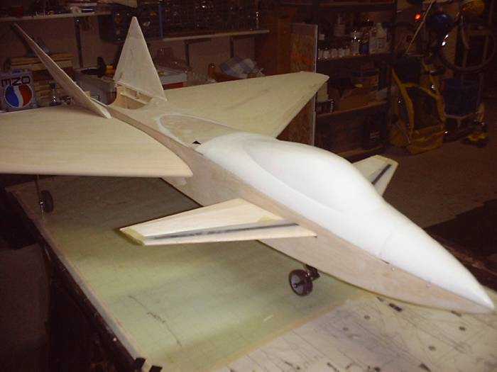

I read comments that the aircraft would "run out of elevator" on landing, so I enlarged the elevators. This lead my to think that the stabs could be a little weak, so I added .007" by .500" carbon strips top and bottom to the stabs.
And here's a pic of the stab with the carbon. I basically added 1.5" to the root of the elevator and tapered it toward the tip. This made the elevator trailing edge straight rather than swept

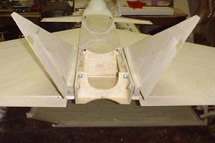

Anyway, thanks for the caution. I added .750" hardwood dowels to the fuselage to mount the blind nuts for the stab screws. Sorry for the poor quality of the pic. I think that you can make out what I'm talking about. I put large aluminum washers under the heads of the mounting screws as well. My reaper will be powered by a JDE 54 and I hope to have it at MESA in a couple weeks...

With Marc's advice, my buddy and I strengthened the base of the fin where the bolts go through by inserting 3/8" dowels through the balsa, and a wedge shaped piece of spruce inside the fuse so the blind nuts will sit at right angles to the bolt.
Because we are using a heavier engine, and seem to be adding weight behind the cg, we are going to epoxy the fins on, using the bolts as clamps. When dry, we will pop the bolts and blind nuts out, and epoxy carbon fiber shaft to fill the holes. Hopefully, at that point we can remove some of the added spruce wedge as well
