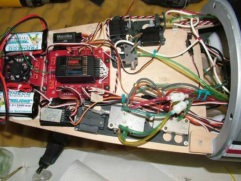

ORIGINAL: avicom
Can I use these one in my jet? http://www.smart-fly.com/Products/Expander/expander.htm
Rgds
Alejandro
I have seen it first hand, it is very light and it appears to be very good, but I haven't tryed it...
I have a power box in my F-18, no problems at all... I used to have voltage problems before, which actually caused a flameout, but know it is perfect and safe...
Saludos...
Michel
