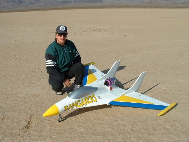

Old 01-16-2002 | 11:45 PM
Posts: 194
From: Las Vegas NV.
Default pic
Hey bkf here is another pic for your Roo pic web site
