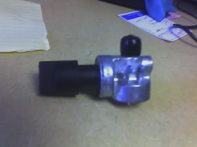

I have a really sticky propane valve. Its a projet solenoid valve. Last week I logged about 14 flights on my jet and all but one had an automatic start. The valve froze and I had to do manual propane injection. Needless to say, I got good practice in manual starts, but its something I would rather live without.
I know sticky valves are kinda common. How do you guys unstick these? I have shot in silicon lube, but no luck yet.

I toss mine out completely and use offboard propane for my starts. A lot smoother and no carrying of propane along for the ride.
If something goes wrong with a start, my hand is on the fuel source and one click/ no more fuel source.
GNM sells a green coleman valve with 4mm propane end. around 17 bucks. Dreamworks will have one as well like now or soon.

i never use silicon when i have a sticki propane valve i always use a few drops of turbine fuel that i use for flying its got the turbine oil mixed in it thats the lubricant for unsticking the valve

One shot of WD40 with the little red hose has worked for me.. If that doesn't work, throw it in the trash...

I use a shot of liquid silicone once or twice a month as a preventative measure. I like the sound of the WD-40 idea though as well, might try that too.

One thing to watch with WD40 is that if it dries out, it leaves a sticky/waxy brown residue that does a *great* job of gumming things up.
WD40 is a water-displacer first and a very poor lubricant second.

every 2-3 flying session, i put some drops of oil on the festo connector were i fill gas..
no problems so far...
the propane is a well know degreaser, so the reason of sticky solenoids...

Are all your other guy’s using the Projet gas-valve as well??
Cause I did, and it sticked like hell, and needed to be lubricated a lot to work. And I finally dumped it. I had it dis-assambled some times, and I as was surprised that it ever could work: There were practically no power in the electro-magnet! Only a tiny movement, with close to no force.. I was tempted to rewind the electromagnet, but as I have external gas I saw no point in risking to overload the Projet ECU-controller by pulling more amps.
If it works wiht silicone oil, I'll might give it a try, but i doubt it..

I think the projet valves are kinda more prone to problems. I have a jetcat, NO PROBELMS ever.

Valves are in stock, just waiting for the festo fittings to arrive to complete the assembly...

Ya, in my opinion that product right there is the best way to start a turbine on propane. It's so simple and especially if you're running an engine on the stand, boo koo good starts.

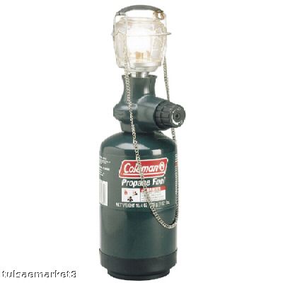

What is this valve? From this pic I cannot make out how and where this will be used. Could you please explain its use? Is it attached at the neck of the main propane/butane gas tank? If so, I am not sure if it will fit the tanks we have in india. [&:]

Ragz, the valve goes on those little 1lb green coleman bottles. Like in the picture
