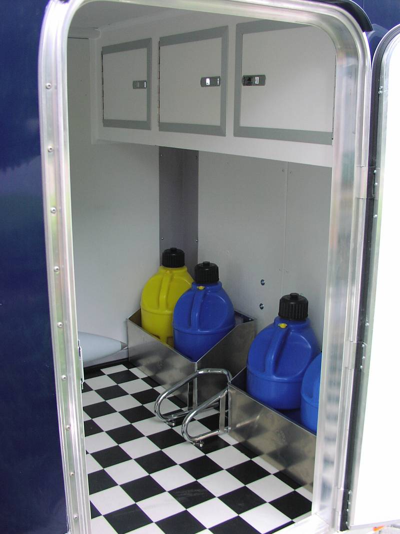

Ian, I would highly recommend cabinets. They carry all means of stuff that would otherwise be a nuisance. I also bought racing fuel jugs as they have a very wide mouth and are easy to fill at the airport. The racks that hold the fuel jugs are also a perfect size for the Jersey modeler Hedwin.
My trailer is very small as I need to keep it in a garage with low doors, but the cabinets and fuel racks help to make the most of the space. My new lightning fits fine on the bottom shelf. Note the E Channel, it is great for adjusting the height of the shelves.

ORIGINAL: pilott28
