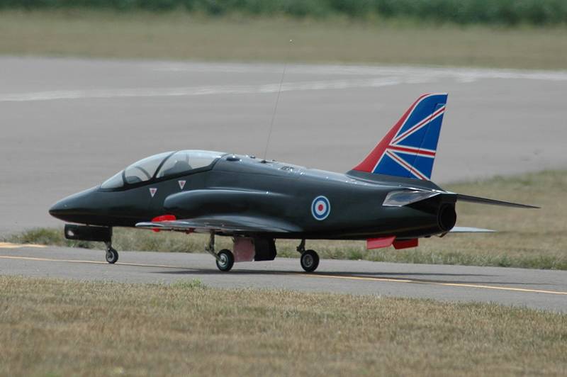

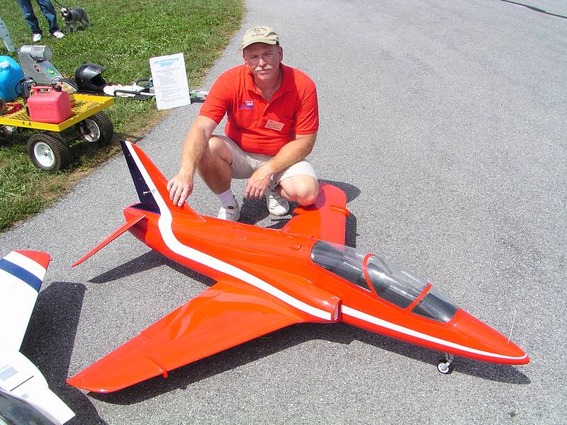

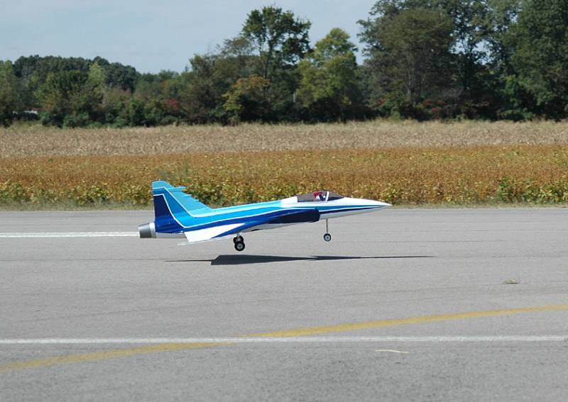

Gene,
I think both Gripen or Hawk can fly with 17 lb thrust engine. We have a demo Gripen with P-70, and a Hawk for Simjet 1700, both fly very well.
