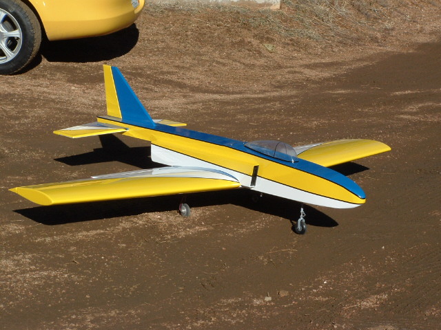

Here is a pick of my latest jet, a Discovery. I built it from plans I bought from Model Airplane News. I should fly it Tues or Wed. of next week. Power will be Wren 54.

Nice looking job! Have you weighed it?
Dave

Dave it weighs 19 lbs 4 oz without fuel, I had to add 1 1/2 lbs of weight to the nose. The color isn't very original, but I like the it.

George,
No I do not. I have a similar type airframe, BTE Models Reaction 54 at 18 1/4 pounds with similar dimensions. I have a P60 at 14 pounds thrust and I know that combination flies fine, yours should too. Verticals will be somewhat limited (for jet standards anyway). Only advice I can give is to use an FOD screen with the bottom mounted turbine. This is one of the reasons I went with the R54 as the turbine is mounted above the wing.
I've seen videos of the Discovery fly and you'll have a blast.....Once you get over flying that much money!
