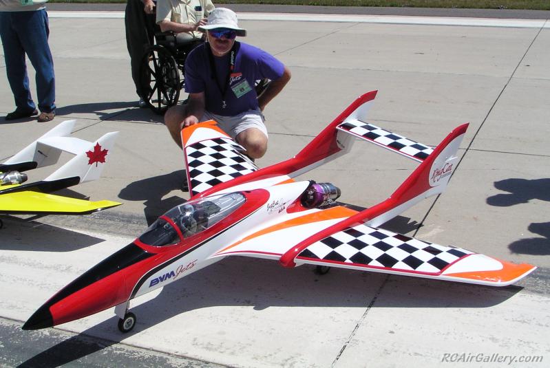

Default RE: Another post about paint
HI all, best finish at Winamac
Rcpete

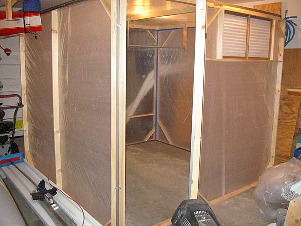

On the subject of paint, I thought you guys might get a kick out of the collapsible downdraft paint booth I use in my garage. Since using this sucker I get no overspray on the stuff in my garage, no clouds of spray mist hanging in the air and no stink in my garage for days. The twin blowers remove the overspray from my HVLP gun so fast that it doesn't even get on the plastic walls of the booth! Twin furnace filters and a charcoal second stage remove the particulates and smell from the air before it is exhausted outside.
This in combination with a full face respirator and I am reasonably comfortable with the protection I am getting from the paint. Of course it would be nice to have one of the HobbyAir respirators too. Maybe next year.
Antony

Nice setup Antony.
I am hoping to build something similar in my garage.
What kind of fans are you using to remove the exhaust? Show us some more pictures.
Jeff

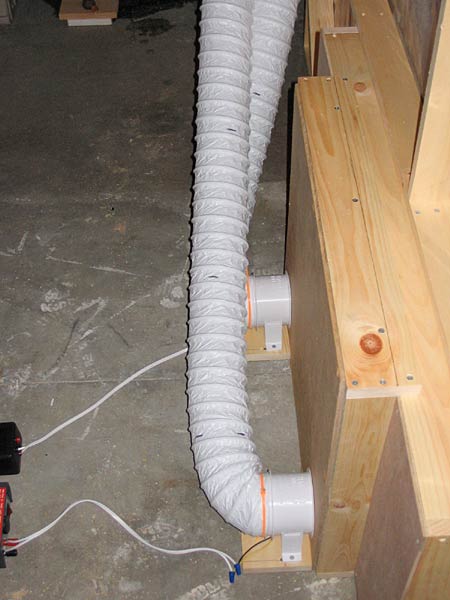

Thanks Jeff. I am really pleased with how this booth works. I am using two marine bilge blowers to remove the fumes and overspray. They vent to the outside world through 2 - 10'L x 4"W flexible marine hoses that are fit into a window insert. My booth is 8'W x 8'L x 7'H which is approximately 450 cubic feet. My blowers each move about 450 cubic feet of air per minute (i.e. 900 CFM combined) which seems perfectly adequate for my usage with an HVLP gun. Intake is via an opening in the booth covered by two 20" furnace/AC filters. The exhaust port is also covered by two 20" filters and behind them is a 30" x 20" (guessing on dimensions there) charcoal filter.
Ray, the gun you see is my cheapo primer gun. For real painting I use a Devilbiss SRI HVLP gun. Very nice quality hardware and almost impossible to get poor results, particularly if you follow the infamous David Reid "reduce it 200%" rule.
Here are pics of the bilge blower used as well as the exhaust fan assembly.
Gee David, more power to you. I would just as soon reduce my exposure to this toxic stuff, and that includes cigarette smoke. Our lungs are pretty sensitive and damage to them is cumulative.
Antony
