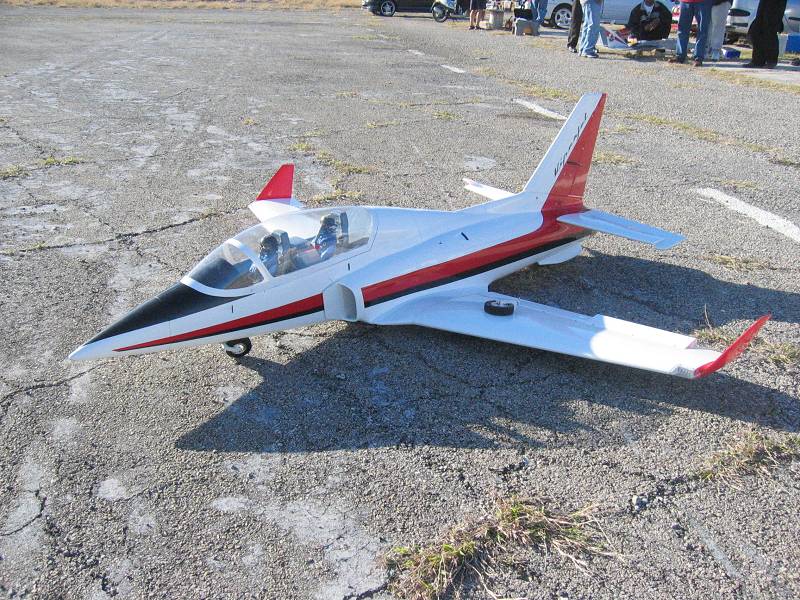

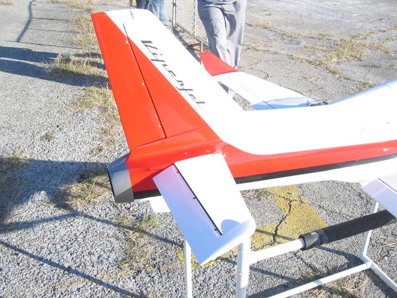

Today was a beautiful day to fly my brand new Viperjet MK 11 powered by a simjet 2300.This was my second time flying this jet,when all of a sudden the whole back of the jet started to shake violently from FLUTTER.The back hatch flew off,the front hatch had pushed into the fuselage,I immediately went to idle on the throttle,made a left turn,droped the landing gear down,control of the jet was very mushy and the jet was coming down fast and very little control on the elevator.I managed to land the jet with one elevator servo working,breaking the brand new landing gear, bending the nose gear and bending the spars on the wings. After assessing the damage, the FLUTTER was caused by the RIGHT HORIZONTAL STAB coming loose, not from the screws but from the WOODEN BLOCK in the fuselage, this block separated from the fuselage while IN FLIGHT. Looking into the tail of the plane you cannot see this block as it is covered by the back former. I lost 4 digital servos,bent both wing spars broke 2 struts (mains),bent nose gear and 1 hatch latch, all caused from STRUCTURAL FAILURE. I will contact TAM tomorrow.

Sorry to hear about your incident. You can consider your self lucky as flutter on a jet normally is fatal.
I have flown my Viper Jet (first series) for two years w/o any flutter issues at speeds upp to 330km/h on a regular basis (130N or thrust).
In my opinion the elevators and rudder of the Viper is sensitive to flutter if you don't take any precautions. By mass balancing the elevators (approx 20g in each tip of the elevators) and similar to the rudder you will reduce the models sensitivity to flutter.
The wooden part that came loose may be a secondary effect of a self induced flutter. The forces of a flutter when your jet is doing 150mph can easily rip out the servo of the elevator or fin or destroy a nylon gearbox of a servo. Always use metal gearbox.
I know the Mark II is a bit tail heavy an you may not want to add 50g of lead in the tail. However, if you do a proper mass balancing you can operate the elevators and rudder with a 24g Digital wing servo (Hitec HS-5125MG or JR DS161).
It would be useful to se a picture of the servo installation in the horizontal stab. Please check if the servo has come loose.
Also very important is to have a rigid an slope free linkage/control of the control surface.
