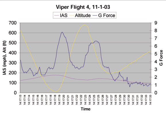

Here's some G data from one of Tam's Viperjets taken in 2003. About a 600ft diameter loop, entry at ~180 mph IAS. About 8 g's on the initial pull and 7 on the bottom of the loop. G's relaxed to around 3 at the top. V^2/R gives you a reasonable indication of g's if you were flying a constant radius and velocity.

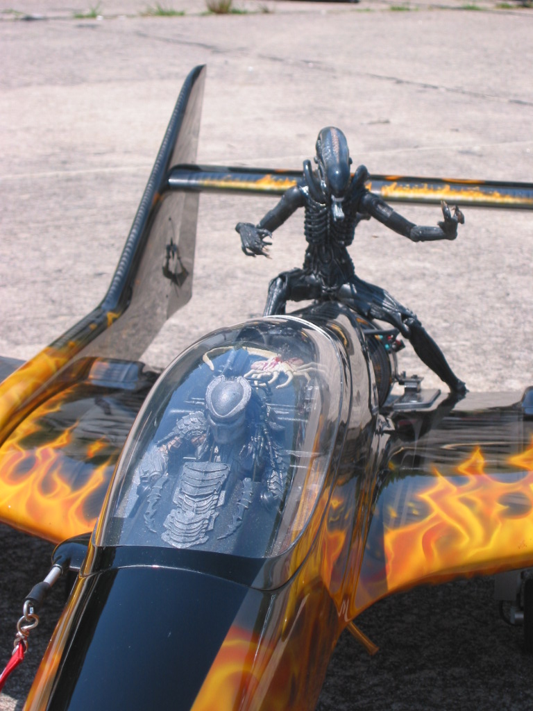

I wittnessed the smile on BV face as the mains contacted the runway at Liberty bell. BTW I know know why you use the "Alien" as a pilot. Fly like your Hair is on Fire.........
