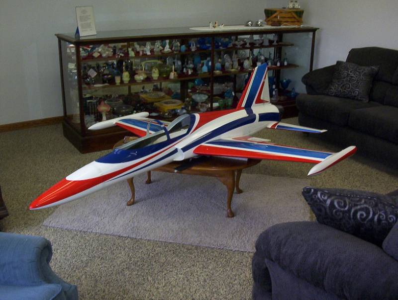

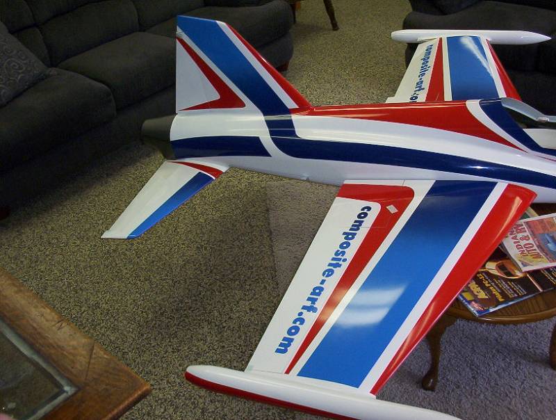

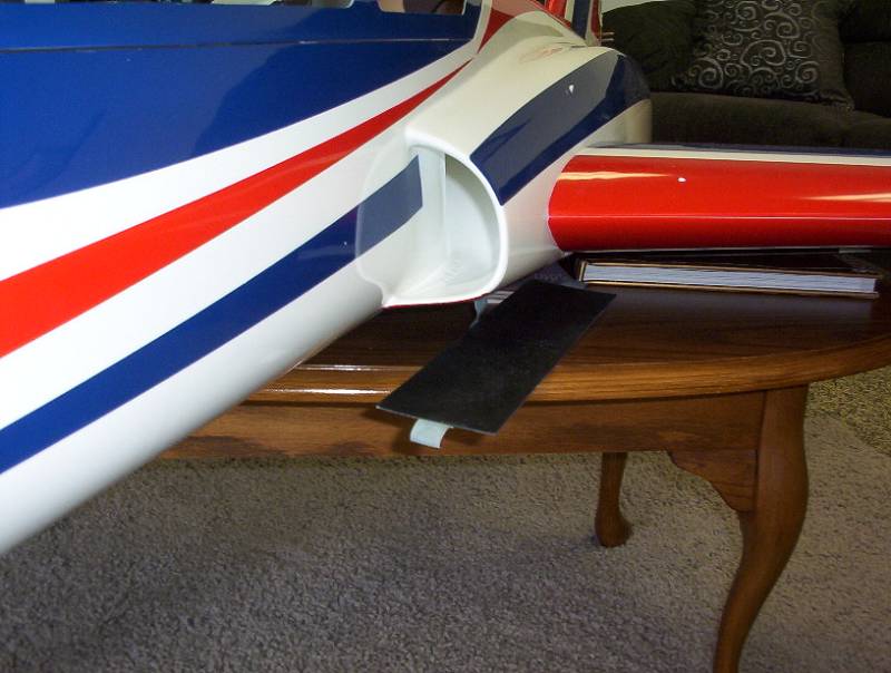

Gary,
I received my Lightning kit Wednesday. Ghost_rider came over Saturday and we unboxed it.
My first impressions of this kit, to say the least.....awsome. I had no idea that the quality was so high. This one will take very little time to finish. I am putting a 160 in mine,,,, as soon as it is upgraded to kero-start.
Keep us posted on the flight report.....
best regards,
Ron Ballard
