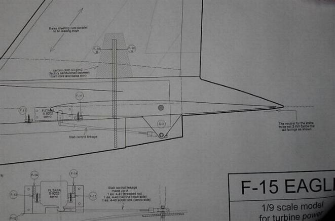

Hi all.... I would appreciate any assistance setting my cg point and taileron nuetral position. Its the turbine version and has a P80 installed. Thanks!

I have taken digital pictures of the info you need from the Avonds plan sheet. The pictures are too big for R C Universe, and if I shrink them, you can't read the notations. If you'll privide your Email addy, I'll send them to you.
Until then, here's what I can provide through this venue.

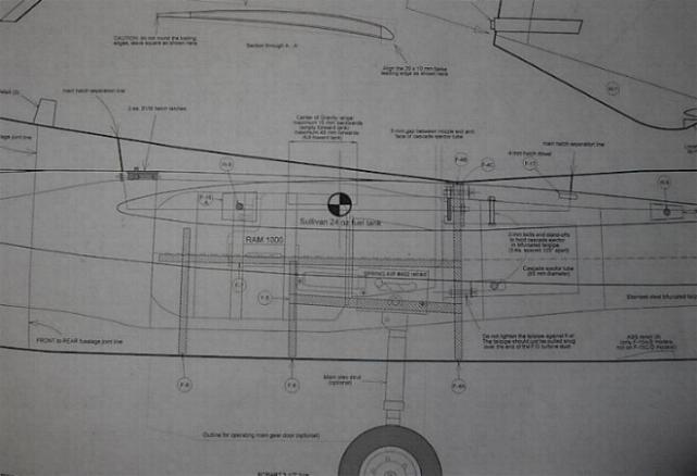

C/G
[email protected]

Hi
Johnny Hernandez sent me this measurement for my Avonds
F15,measure 29.5 inches from tip of tailcone no fuel and
gear down my fuel system comprises three tanks two mains on CG and one forward which empties first and a UAT gets up off grass at about 170FT flies like a dream.
elevators are set as per plan
Have a ball must be one of the best first time jets ever made
congratulations Mr Avonds
