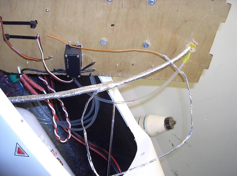

Reading the very interesting article about fuel pumps in the latest RC Jet International, made me aware of this "NOTAM".
Feb/march 06 page 60.
Quoting:
"During our visit Peter brought to my attention a courious matter. While testing pumps at night Peter discovered a surprising phenomenon.
He noticed sparks jumping from the fuel lines.
He also found that the plastic fuel lines would move when a powerful magnet was brought near them.
This points to some electromagnetic activity arising from the flow of fuel in the fuel lines.
Convinced that this could be the cause of spurious radio "gltching" when flying his Panther.
Peter has screened all his fuel lines and bonded the screening to the tailpipe, engine case and ECU power supply"

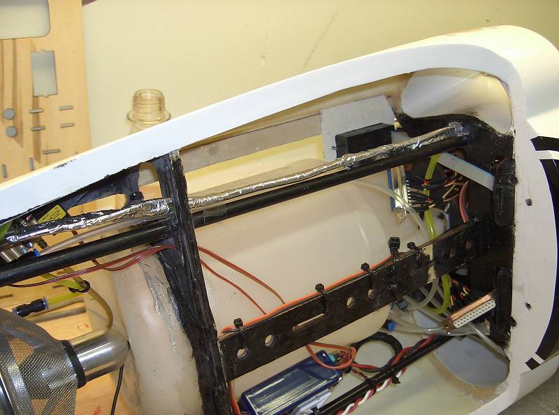

I have just finished the screening, using thin alu tape, very well suited for the purpose. A wire connected to the screen, is connected to the negative on the ECU battery. This wire is screened as well, as it will act like a aerial full of unwanted stuff. The negative on the battery, has a drain effect to the screen/shield. This must be connected to the ECU power, NOT the receiver battery!! However, if this wire is connected to the positive, the drain effect will be exactly the opposite, meaning the screen/shield has no effect at all!!
This is done on my Boomerang XL.
