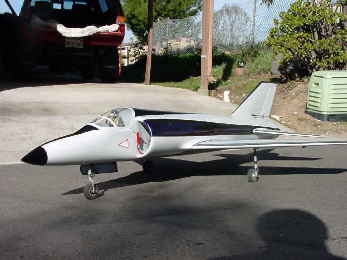

Thought I'd share my first Jet experience now that my knees stopped shakin'.
Meet TAZ! He's a Yellow Starfire II. Power is a BVM 91R and Viofan unit. Had to do some modifications to the ducting and cast a new top cover to facilitate this unit. Springairs with Glennis wheels and brakes. Hitec digitals on all flight surfaces. Opted for the removable wing set up.
First flight was a bit shakey (me not the plane) and it took a while to get it trimmed out. Damn this thing is FAST. Managed to get it back to the original starting point and made an acceptable landing (arrival?) even tho I forgot to use the flaps...long run out and hard on the brakes.
Second flight was much nicer and I managed to remember to use flaps for the landing. The plane floats forever with flaps set as per the instructions. Now have the flaps set up to go about 45deg., that should slow it down some.
Highjly recommend this plane as a first jet.

Congratulations Walt,
After the 1st couple of flights, its easy to start enjoying the plane and exploring the envelope..
btw, what's the little red flag by the left intake?

The plane came in at 13.8 pounds. I'm sure I could have made it somewhat less. The Glennis wheels and brakes are a bit heavy. I also used a up-3 valve for the gear as I put pneumatic actuator for the gear door. 12 servos and a hush kit. Also, I got a little carried away with the paint.
However, at this weight, it flies great!! I now have 5 flights on it and have yet to scratch the paint. It's off in about 100 feet. Having a little trouble with the landings tho. I just haven't learned to trust the slow flying characteristics yet. It seems to land better at half flap than with full flaps. I think I'm coming in too hot for the full flaps and it bounces and balloons several times before it stays stuck to the runway, again, thank Glennis for the brakes.
All in all I'm very happy and look forward to flying this plane WITHOUT wearing Depends some day.
Walt
BTW Hank, the red flag is the power switch. It's from Reliaswitch and is an optically isolated switch that, if it fails, fails on. I am using Powerflight Lith/ion 7.2 volt pack regulated to 6 volts.
The switch is available from RCShowcase. I have used these for some time now and really like them. A little pricey tho.

Walt,
Congratulations! I'm so glad to hear that you finally got it airborne. She looks great. On the landings, go ahead and chop that throttle and let it slow up. Take it usptairs and drop the flaps. Slow it down to idle speed into the wind and see how slow it will fly. You'll be shocked, and that will give you some confidence as far as slowing it down to land. If you think it's getting too slow, just throttle up. That's when you're glad of those huge inlets, because the plane will accelerate QUICKLY. When you get more comfortable, try this just for grins: Full flaps, full elevator, full throttle, then release brakes. Once it breaks ground, relax the elevators a bit, cuz it's gonna rotate in about 70'! Have fun!
