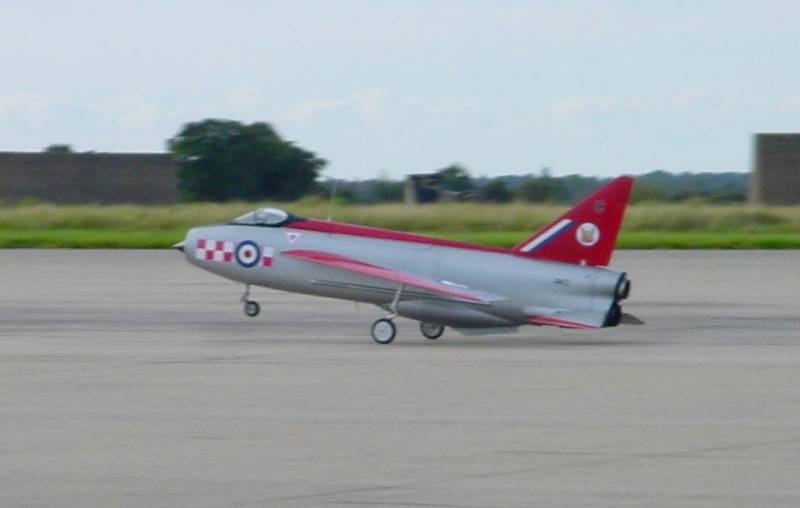

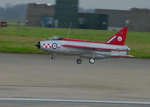

Dear Rob
Yes there is get a proper Lightning.
Regards Phil G.

Thanks for that Phil, nice looking E.E. Lightning, I hope this version of the Lightning flies as well as the previous fullsize that carried the name.
