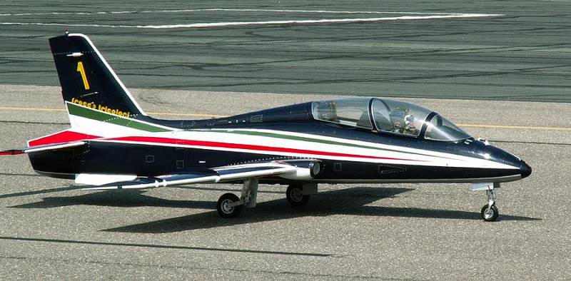

Is anybody out there building or completed a Skymaster MB339,as I would like some advice.I'm currntly putting one together.complete with everything,Has anybody come up with a hinging method for the airbrake,as there is nothing supplied in the kit,also how are the cockpit detail tubs and dash installed.I could probably figure it out given time,but if somebody has a proven method,why reinvent the wheel.
I will post some photos when completed. It will be powered with a Simjet Nexus.
Hope somebody can help me

Hi John, I bought one of the factory 339s that were flown in the 05 wjm. Though I am an experienced model builder I did'nt have anything to do with the set up of this model, You are though welcome to any picture or description of the way this model is completed.
Mick
ps, I'm still waiting for some decent weather to get my first flight with it!!

Hi Mick,Many thanks for the offer.If you are able,could you take some photos of the canopy and cockpit and if possible the hinging of the airbrake.In the kit the canopy has a fibreglass reinforcing piece across it,front and rear,also in the fuselage itself and without removing these,I dont see how I could install the tubs.Any information at all would be helpfull.
