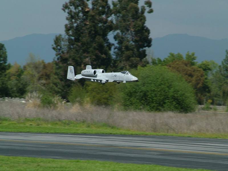

Hi guys, I just finished mine. The 120 in a great choice. I would not go any bigger as you just don't need it. Take off is 3/4 power, flying aroung at a scale speed is just under half ( without full flaps). There is plenty there for those high cuban eight, and not a problem on landing either with static thrust. 1 pound to 1.5 extra lead in the nose. She lands in as little at 300' . Rotates is 450'. By far the best fly'n plane I personally have ever flew. This plane is awesome in the air and on the ground. DDennison feel free to call me if you have any questions. Welcome to the hog family. Billy Edwards

Thanks Billy!
Your plane looks amazing. I can't wait to get this together.
Did you have enough information from the "instructions"? I would be interested in any parts that you found tricky or requiring modification or reinforcement.

LOL,
I think I know what you mean..going first has its adv/disadv.
Do your LE inboard slats function?
That plane looks REAL.

No they don't function. Unless you want them for scale effects, the plane doesn't need them to slow down. It is amazing how slow you can land this plane. Almost as slow as a Bobcat in crow. Amazing

The inboard slats were not used on the full scale for takeoff or landing. Their function was to extend at high AOA and keep the air over the wing in front of the engine from separating and causing compressor stalls. We hated them because they caused significant drag just when you didn't need it.
GREAT looking airplane!
