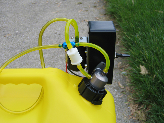

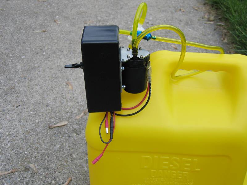

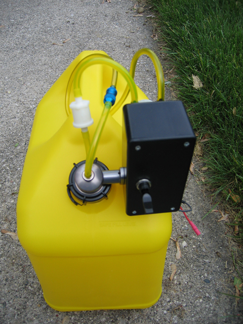

After collecting the various pieces needed to make new my fueler I still needed to decide how to mount all this gear to the can and I was looking for something better than sheet aluminum. I found the solution at the Slimline Product booth during the Toledo show.
They just released this new fueler to work with the new style ventless fuel cans. I'll let the photos do the rest of the talking.

Nice setup. Is that a Sig [link=http://www2.towerhobbies.com/cgi-bin/wti0001p?&I=LXDJR7&P=7]Gas Passer[/link] pump attached to it? I assume that the slimline part you are referring to is the machined aluminum cap?

How well do you think the neck will hold up over time to the weight of the batteries and the pump bouncing around during transport?

While I have not weighed the completed unit, I do not think there will be an issue with the neck of the bottle carrying the weight.
I can weigh it tomorrow if you like. Weight is 1.75lbs
The slimline unit was $40.00 bucks which included the nicely machined metal cap and standoff, tubing, clunk, self sealing fueling probe,fuel jug and a hand pump. The pump is the Sig Gazzer $35.00 and the 5 gal jug was $7.00 bucks at Lowes. The box and switch came from radio shack for about $10.00, two filters $5.00 each and the 6 cell Nicad pack $2795.00 came with my P-70.
One of the reasons I went this way was to have a mobile fueler. Since I only fly a P-70 a 2.5 gallon container will provide me with 5-6 flights at the local flying field so I don't have to carry as large of a fuel container on those days. Then when I go to a multi day meet I can simply move the pump system to the big container. Also it would allow you to transport a fuel system in say a jetcase and then you can stop by Lowes and pickup fuel jug at your destination.

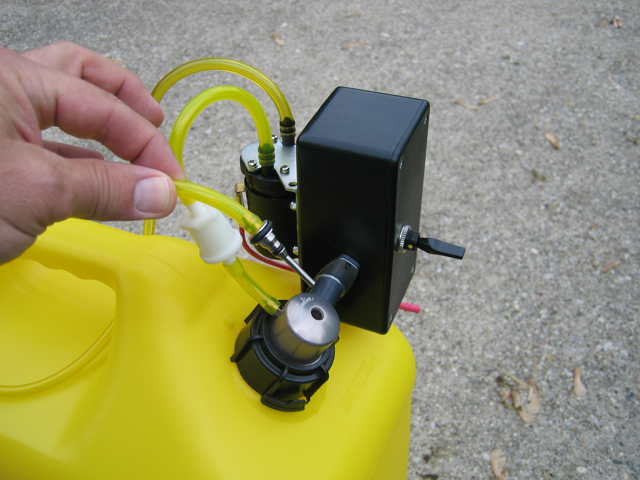

I can't work out though how the switch box is mounted exactly[&:] I've looked at the web site from Slimline and still can't work it out, sorry for being stooopid........
It looks as if something goes around the can neck, which attaches to the rod/tube that goes to the switchbox and I am assuming the cap then screws on ever retaining it......
If that is the case, could you show us a picture close up, if not then explain to this dumbass how it works!!!!!

There is a bolt that holds the standoff to the metal cap. The standoff has a flange and is predrilled and tapped for two 4-40 screws which hold the box to the flange. I even drilled a hole in the side of the battery box so I can loosen the bolt that secures the standoff to the cap so it makes it easy to remove the battery box from the cap.

It was my project box. The plastic could only take so many bumps before it just broke right where I had the box mounted to my make shift aluminum mount.

Thanks for the reply. I do not see that being an issue as the flange is 2" wide and one end is close to the bottom edge of the box.
But I will keep an eye on it.
