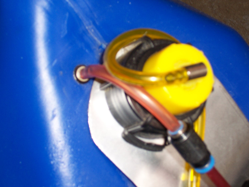

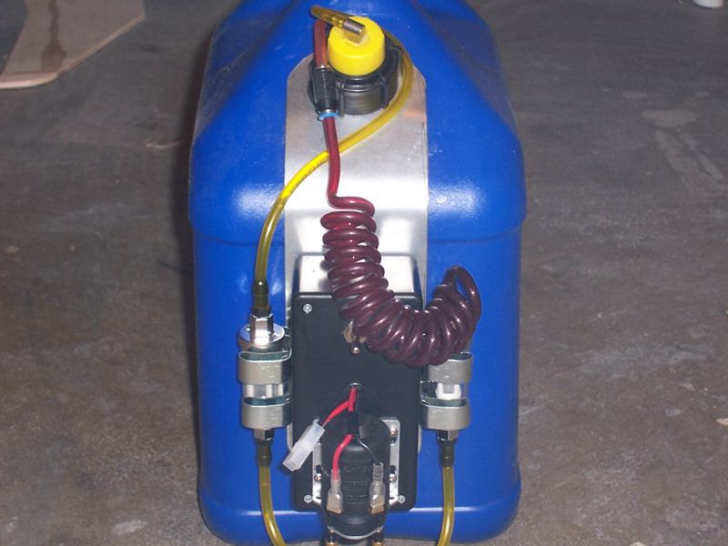

Gazzer, here you go.
Parts List:
• Sig Gas Passer 12 volt fuel pump $31.99
• Radio Shack 6x4x2" Project Enclosure $4.99
• Radio Shack 9.6v 1600ma Battery Pack and Charger $29.99
The kind that they use for the RC cars and stuff, Or look around your work shop!
• Radio Shack Battery Pack Connector Kit $2.99
• Toggle Switch DPDT with Center Off Position $3.49
This will give you Fill>Off>Empty
• Hardware Store - 1 pack Crawford Medium Grip Clips $4.95
These are the large clips pictured. It also depends on the filter you go with.
• 1 piece of Stainless Steel Blank $6.95 - Local Hardware Store
• Kerosene Jerry Jug $5.89 - Auto Parts Store
• Filter $9.00 - Auto Parts Store
• Tygon Fuel Tubing $Free I had some laying around
• Misc Nuts, Bolts, Festo Fittings, Wire $Free Found everything in my parts bin

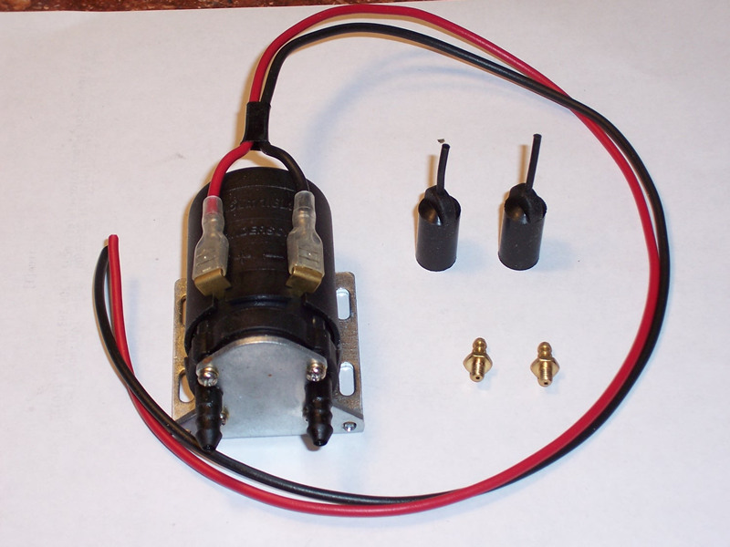

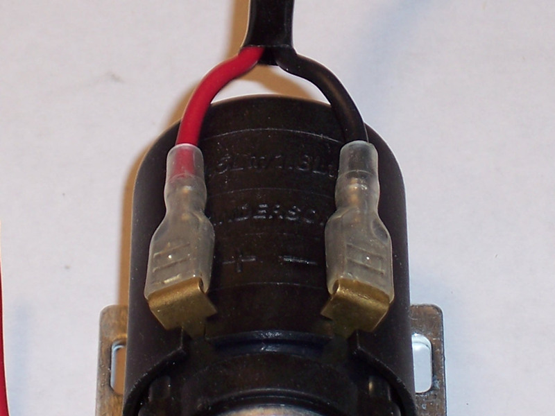

Here is the Sig Gas Passer. It comes with two nipples that you can use to regulate the fuel flow, Save these. You also need to make up your own wire connection. Below are some pictures of the pump as it comes from Sig, the pump with the wire connection, and the whole set up ready to go.
ID:	462400   Click image for larger version
ID:	462401   Click image for larger version

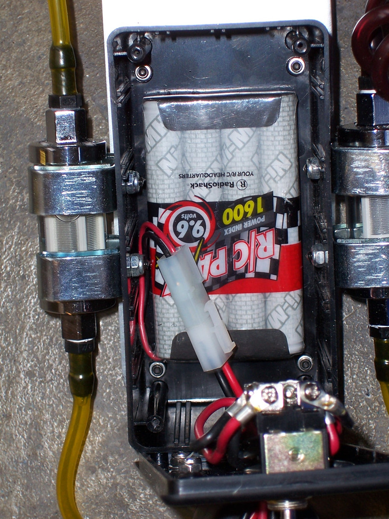

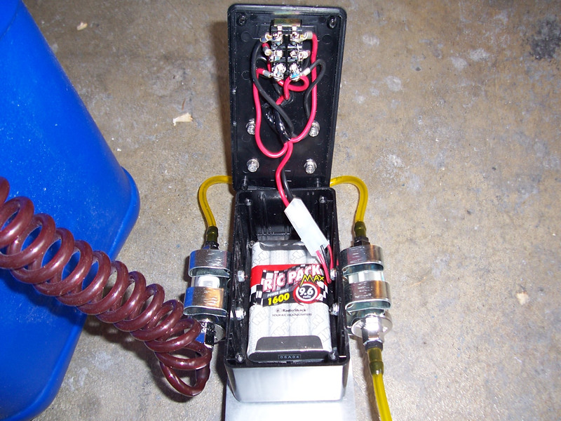

The pump is rated at 12v. I went with 9.6v as to not over work the pump or my tanks. It will also keep the air bubbles to a minimum. Here is a picture of the battery located in the bottom of the box. I used some Velcro to hold it in place.
ID:	462403   Click image for larger version

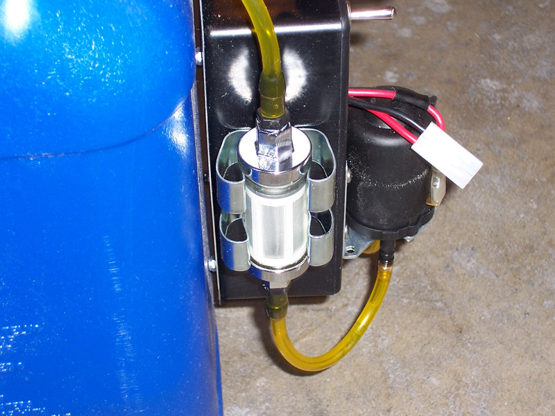

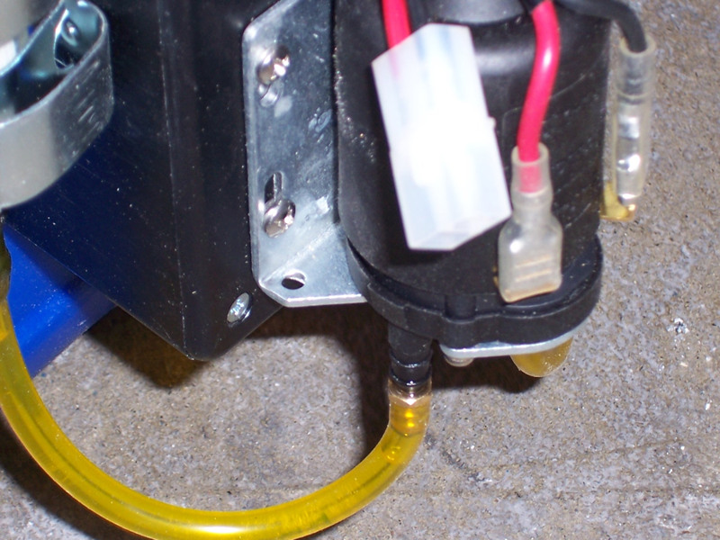

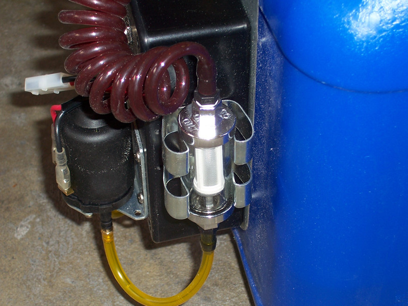

I went with two filters one between the fuel source and the pump and one between the pump and fill line. I also used the supplied regulating nipples. I tried it with out them at first but there was to much air in the system for my likening. After I installed the nipples all the air in the system was non existent. You can also see my charge lead poking through the center of the box.
ID:	462406   Click image for larger version
ID:	462407   Click image for larger version
ID:	462408   Click image for larger version

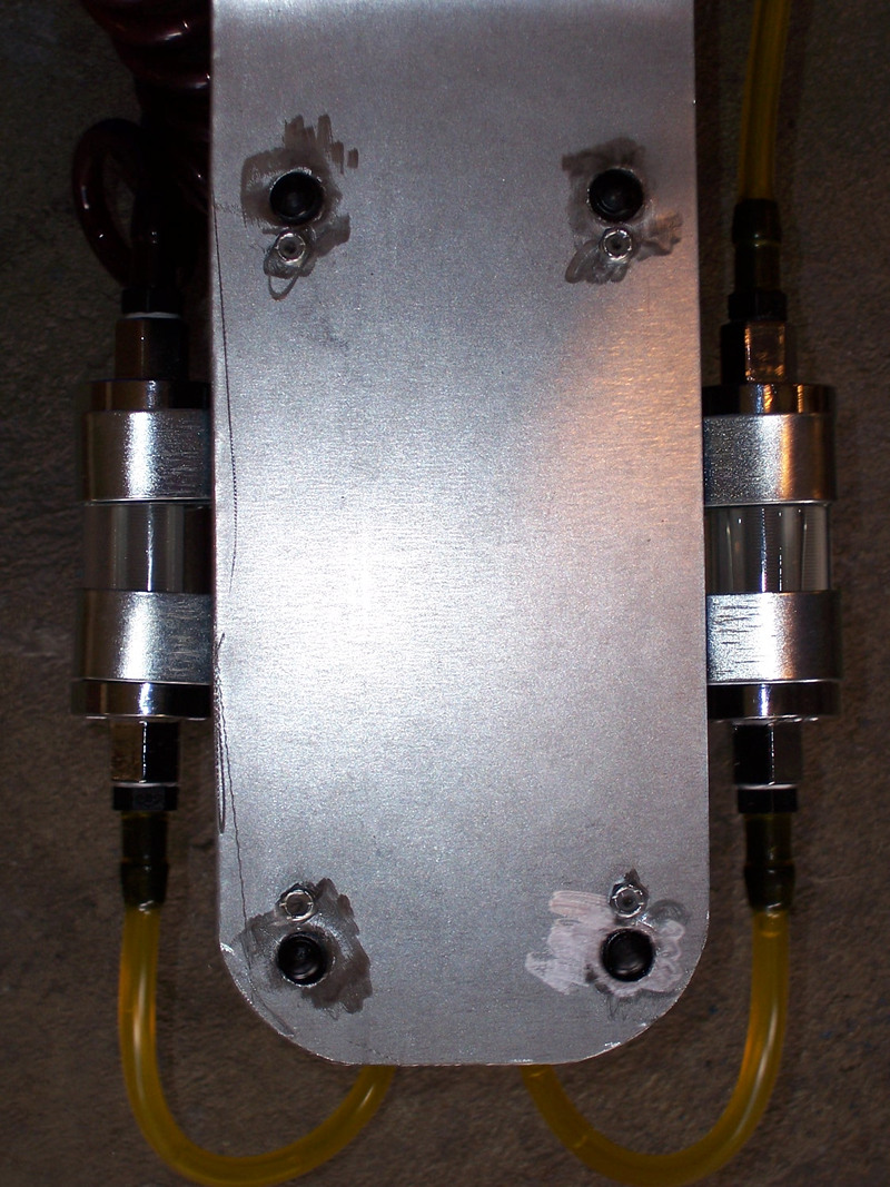

Here is the stainless steel mounting blank. I outlined where I wanted my opening and where I wanted my box to sit. I then used a Dremmel cut off wheel to score the opening. Then I was able to punch it out with a little pressure. Next I took a grinding wheel and smoothed out the edges and got rid of the burs.
You can also see where I drilled through the blank to accept the 4 little stubs that the project box has. Also above each hole you can see where there is a nut. This nut corresponds to the bolt on the inside of the box that attaches the box to the blank. What is really nice about this box is that it has all the holes and stuff pre marked. Kind of like it was meant for this
ID:	462410   Click image for larger version
ID:	462411   Click image for larger version
