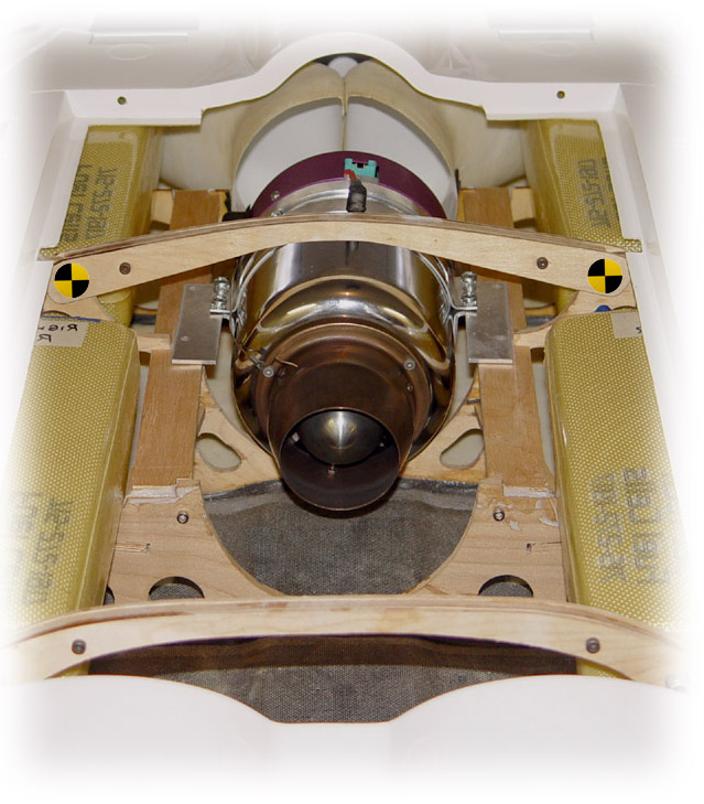

Default RE: SkyMaster F15 CG
If my memory serves me right. It is right on the former. If you are using the Jet Tech fuel cells. Go 1/2 to 1 inch aft due to the two tanks being forward of the CG. It tends to make it a little nose heavy when filled.
