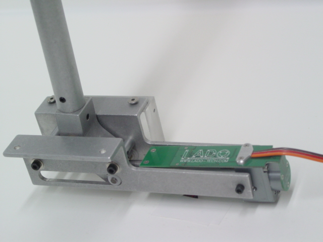

Last week at Castle, there was a company there that had developed new electric technology for
retracts. they where very nice setup. you send him your gear, and he retrofits his stuff into them.
They where worm gear driven, and run off of their own power pac. very light and robust.
he can make them do anything. slow up/down, fast up/down. I will look for my info on them and
post them here. They are located in the LA basin area if I remember correctly.
one of the coolest things about them, they operate like Spring Air units. If you loose battery
power in flight, the gear come down automaticaly. that way you dont have to worry about the
gear not working for you.

I've been working on electric retracts for quite some time now. They are in no means "easy to to", especially the wiring is very tochy and also complicated, as a simple "cutoff" will result in jamming. You need to electronically brake the motor the instant it hits the cutoff switch....not easy from the electronics-side.
I now have the prototype rig up and running, and will soon be building the prototype version.
The "ECU" will be about the same size as the JetCat/ProJet/Orbit turbine ECUS, and tests and calculations show that the cylinders will be "pushing" between 30kg and 100kg (66-220lbs). Gear cycle time will be around 2.5 seconds, with the speed being adjustable for each leg.
The complicity and manufacturing expenses involved will probably make the pneumatic setups financially much more attractive than the electric types, those will probably only show up every now and then....my guess.

Yes, it will include a door sequencer. It is under development for a large (120") F-4 E/F Phantom (and partially an Avonds F-15), on which part of the gear doors remain open and others close. So both functions will be supported. It will, however, not be controlled with a time delay as most sequencers do, but it will work with a position sensor. As soon as the locked-position of the gear cylinder is reached (either up or down), the doors will cycle. That way the door will not run into the gear in case it cycles slower on an occasion (for whatever reason).
The gear itself will be actuated by a cylinder just like the real thing.
Weight of the running prototype is around 150grams, about 5 oz....weight is depending on maximum travel and required power, but with the 150 there should be plenty of power for most uses, including airbrake actuation. Radio glitches have not been noticed.....but we will do extensive range testing before sending one up.
Once finished it will be a foolproof "plug and play" unit, but there is still some development to be done.
We have not considered selling it commercially, but might consider getting something like that on the way if there is enough demand...

Hello all,
This is Doug from Lado Technologies. I am surprised the word is getting around so quickly.
Since our web site is still underdevelopment I thought I would put a few details up here about the electric retract actuator I have developed. Also I wanted to note that our design uses all solid state electrics and no micro switches. All the electronics is built right on to the actuator and still only weighs 2.6 oz. with 35lb. of push/pull force. We will also have a gear door sequencer available soon that takes advantage of some cool timing features built into our actuator.
[img][/img]
The Electric Retract Actuator is a replacement for the air ram in your air retracts. The actuator can fit in most 1/5 & 1/4 scale air retracts from Robart and other retract manufactures. Our electric retract actuator has all the electronics built right on the actuator. Connect the actuator directly to your receiver or through our Gear Sequencer. When connected to your receiver you use the end point adjustments in your computer radio to adjust the speed of the actuator. An encoder build right in the actuator regulates the speed of the actuator. Thus giving you precision control and a very scale looking and reliable retracts.
The actuator has built in electronics that automatically stop the actuator when the landing gear is fully retracted. The electronics also prevents a continuous current draw in the case of a binding retract or malfunction. At any time you can switch direction even if a malfunction or bind has been detected. Also built right into the actuator is a low battery fail safe. This automatically extends the landing gear if the battery voltage drops below a safe point.
SPECIFICATION MIN TYPICAL MAX UNITS
Voltage 4.00 4.8 to 6.0 6.70 Volts
