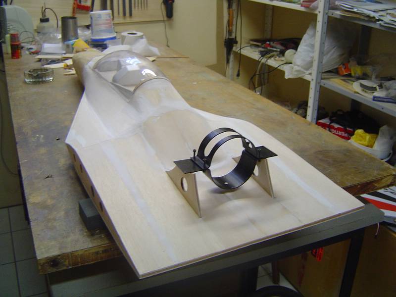

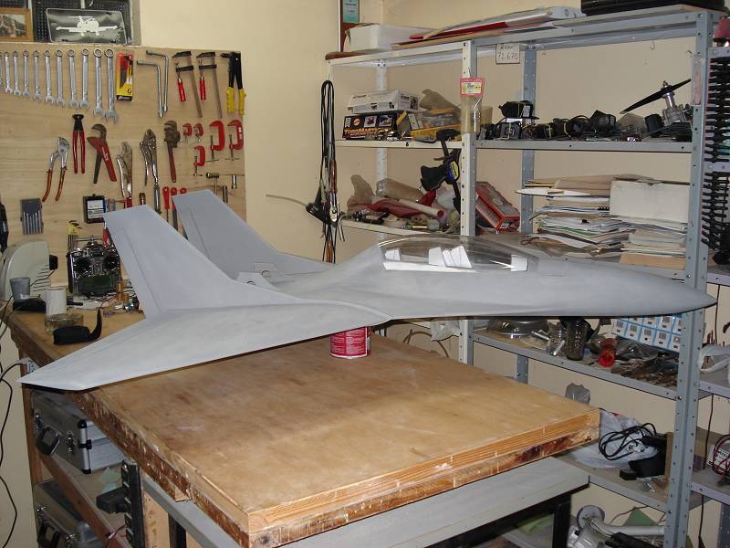

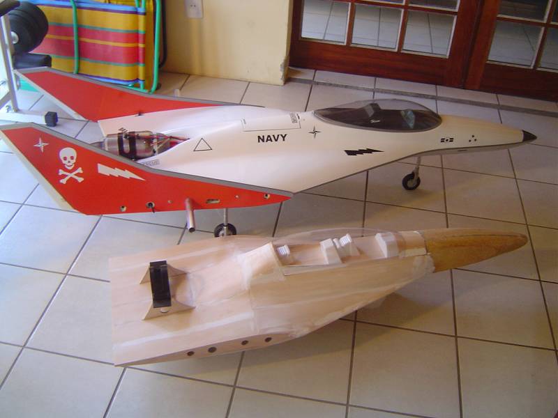

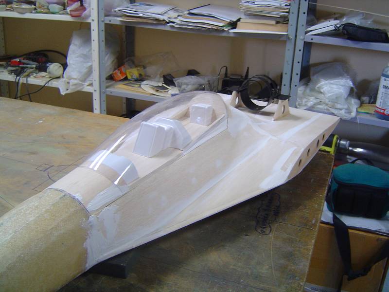

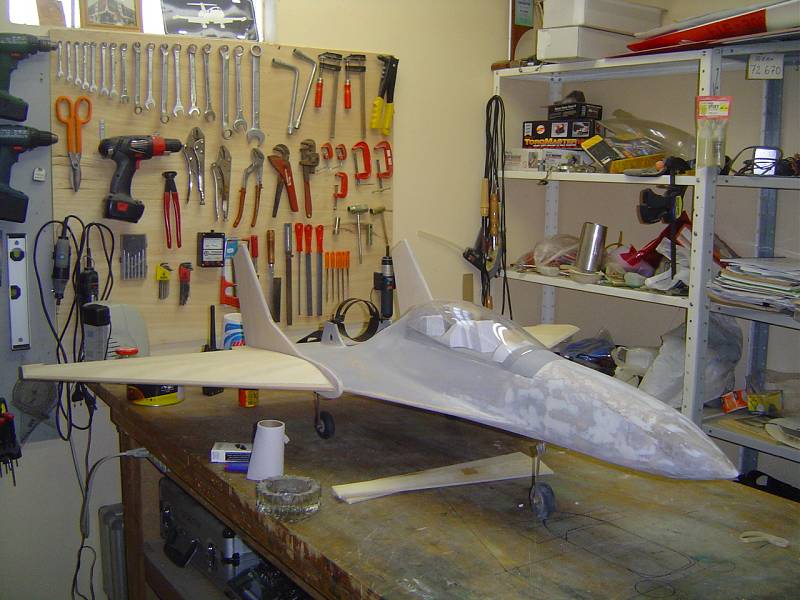

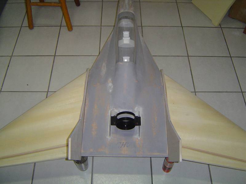

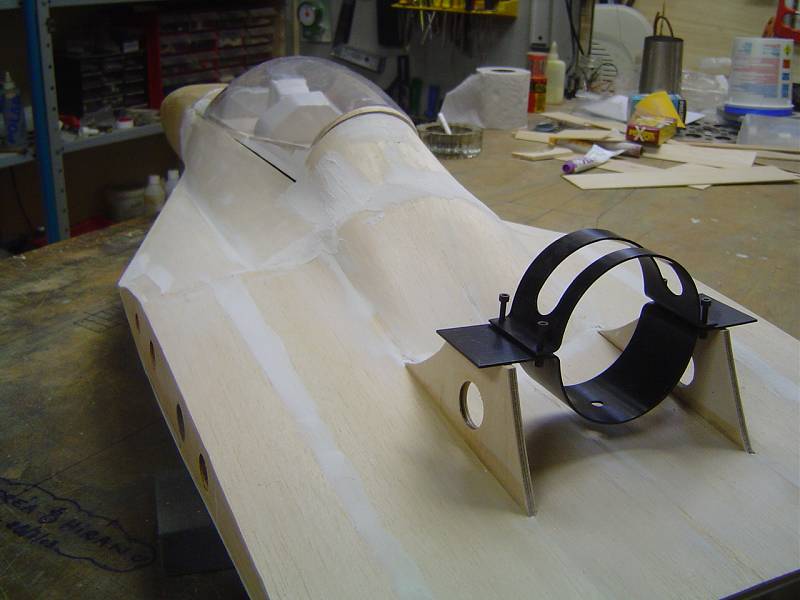

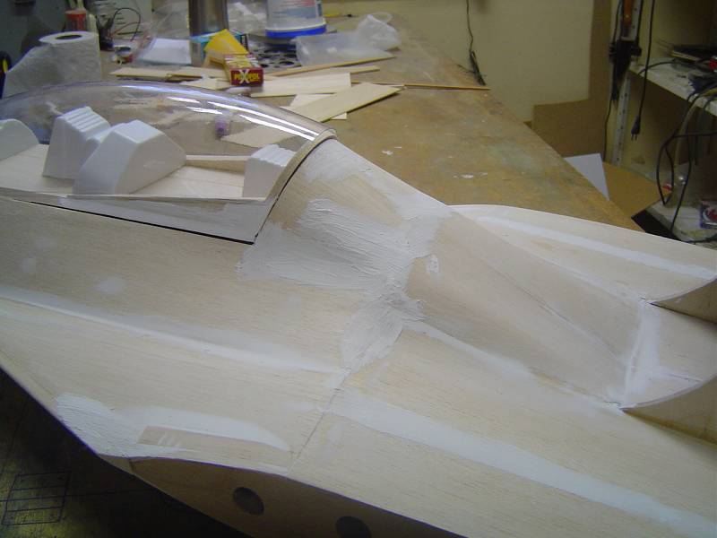

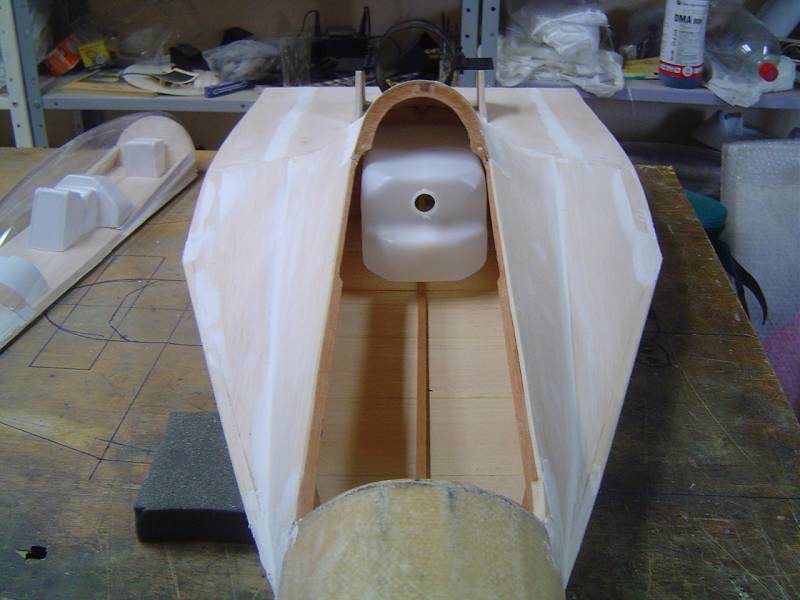

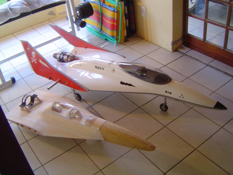

My mini kangaroo......for FTE-500 , tank 40 oz , retratil spring air, balsa.....etc MADE IN BRASIL

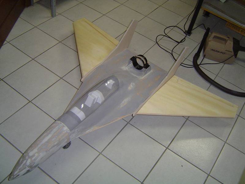

...more....

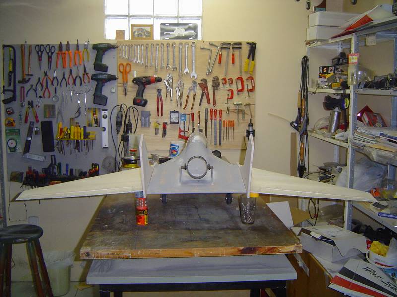

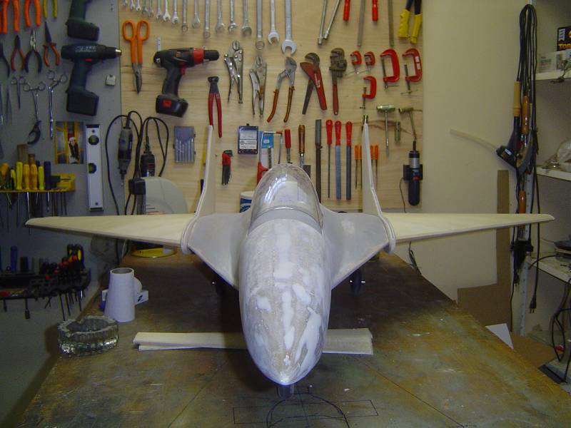

the end.

Looking good, Hiran. I liked the way the balsa was blended in those curves...

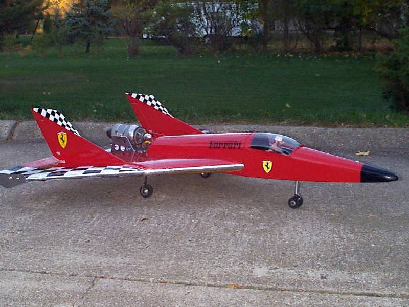

Looks good. I don't think 40 oz. will be enough fuel. Of course it depends on how long you want to fly and how easy you are on the throttle. I have a 64 oz. tank in my Ram 500 Enforcer (see attached). That's enough fuel for a 7 minute flight with about 2 minutes of reserve, in case you have to wait to land or go around again.
Great project. Keep us informed of your progress.

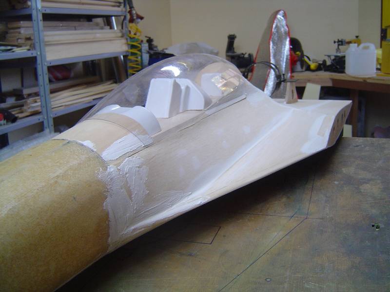

more 06/22/2006.

a cabine de tucano ficou muito boa... estou gostando de ver.

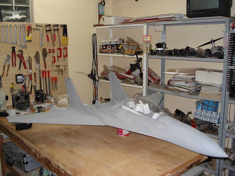

more pics. waiting paint[img][/img]

I searched the web but cant find a supplier of the mini kangaroo or a plan for it
where did this plane come from
i want to use os vr df 90 with short tuned pipe and no nitro for full speed flight on a mini kangaroo type model
balsaeater
Old 04-10-2007 | 09:38 AM
Joined: Aug 2003
Posts: 37
From: pelotas - RS, BRAZIL
Default RE: minikangoo
Hi balsaeater.
The minikangoo plane is Made in House, no plans.
Hiran - Brasil

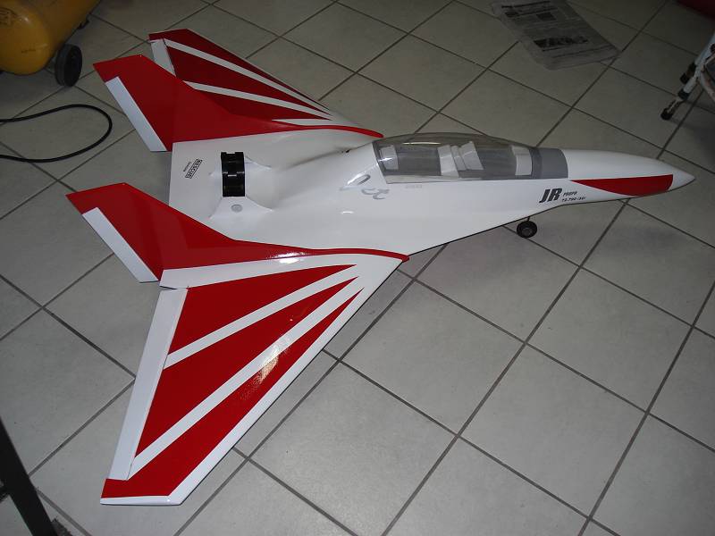

yes tucano canopy. Today paint the plane.
