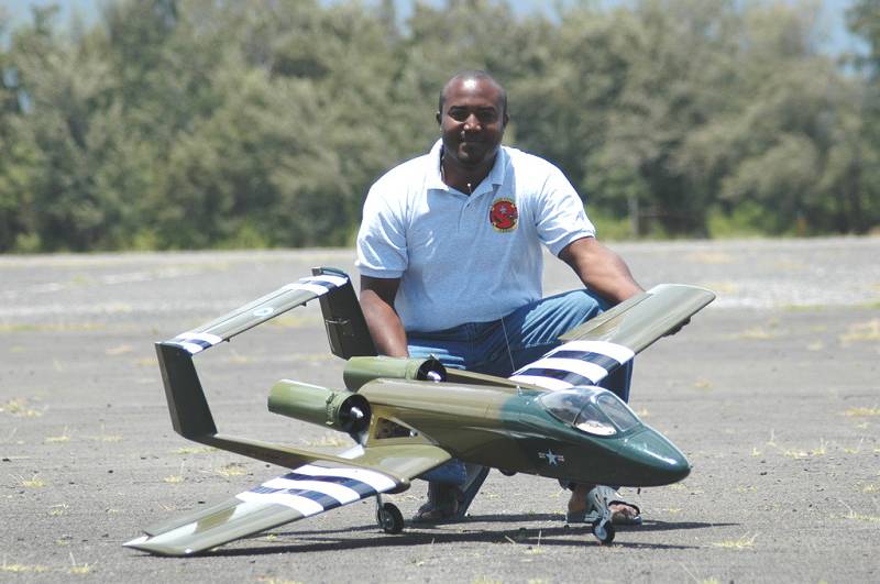

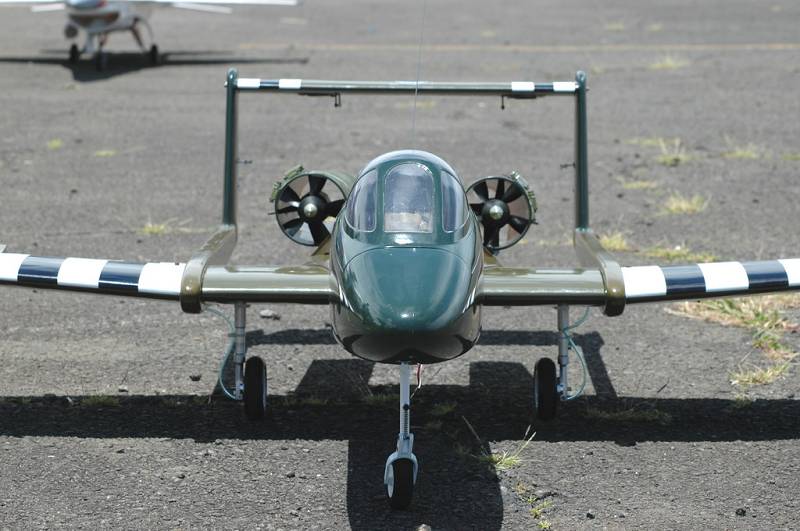

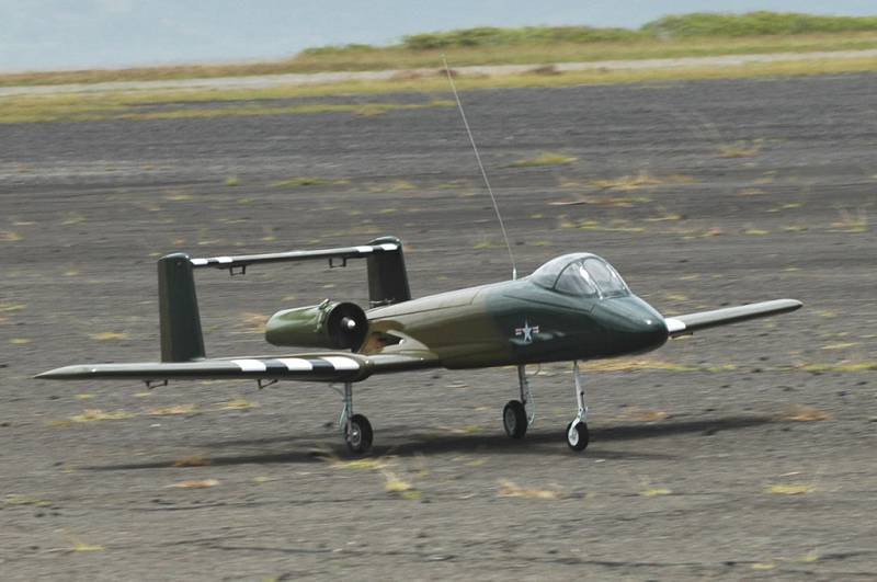

AirPac Models's Avatar
Joined: Aug 2003
Posts: 984
From: Honolulu, HI
Default RE: A-10X, How big a control surface gap to tolerate?
ORIGINAL: Chris True
LOL! Thanks for the input all. I figure about 4,000 watts ought to do the job I happen to have a pair of motor pods, ESC's anda monster battery sitting unused
Chris,
Kevin's A-10xe with 2 AP-900 and Mega 22/30 have very good proform. It's a fun plane to fly with either EDF or turbin.

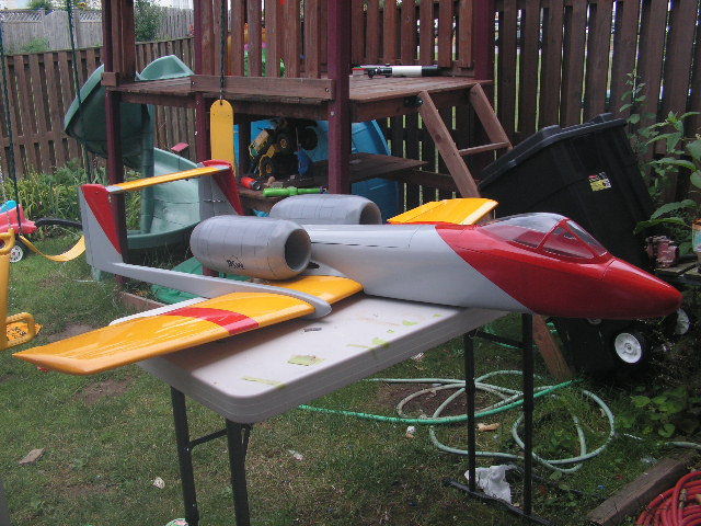

My Feedback: (14)
Posts: 524
From: St. Mary\'s City, MD
Moving right along, I installed the fans last night and screwed everything together this morning. It's not finished yet but a good opportunity to admire it and make airplane noises .
I need to add a few more feet of servo extensions, make a battery mount and install the main retracts once the parts I need from Robart come in. Robart is OK [8D], I bought a set of 530W1's a couple years ago. Ordered 90 degree units and the package said 90 degrees but they were actually 85's. I was using them in my A-10 at the time so the 85's were OK. I called em up to ask about what parts would be needed to make them 90 degrees - side frames. "Since we screwed up, we'll send em free" Can't beat that!
