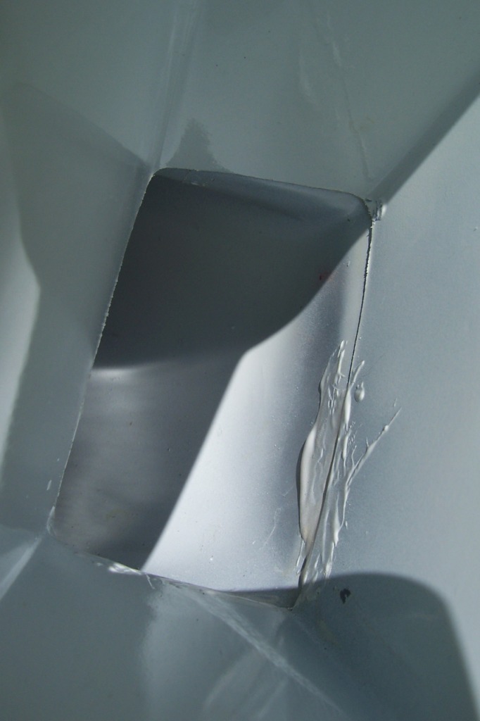

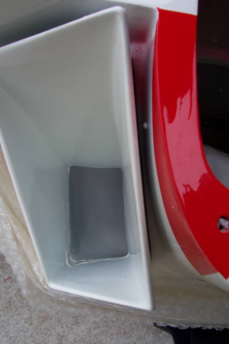

Yes, it would be nice to hear about any other issues, I'm not overly impressed with the finishing I received on my Skymaster F18E, I was under the impression I bought a clearout "now on sale", not a second, their reply back was:
We do understand that the paint job on this plane is not perfect, and also we do understand about the glue in the airplane not being perfect but that is why the plane is on sale the regular price for the F-18E phototype is $2190.00.
P.S. this is not intended to be a skymaster bashing session, I just have the same quaulity issues as the above guys, before I start buying all there accessories, by the way "how hard is it to have the same color white throughout"
Goose is out
